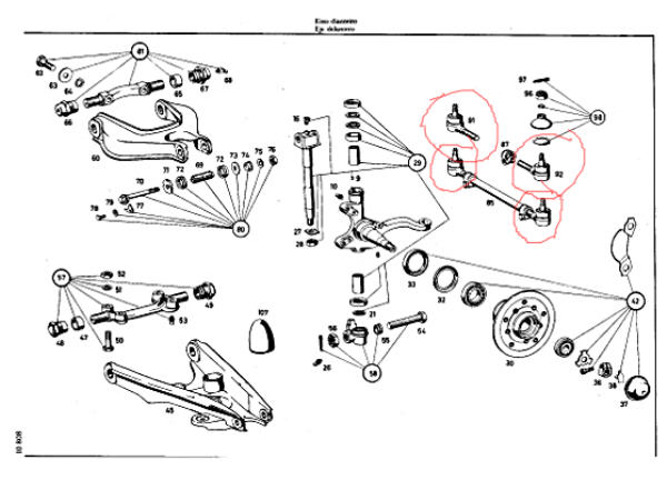

The steering should be tight and responsive with little or no play in the steering wheel.  I suggest you look at the steering linkage.  The attached images may help.  If is wanders on a flat surface an alignment may help.
Good luck
