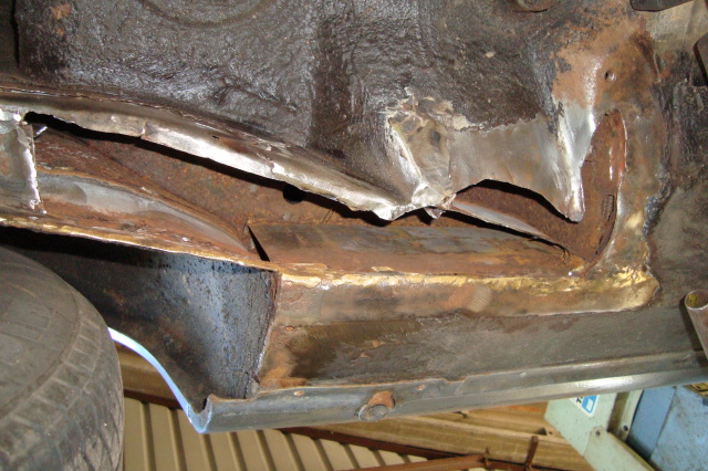

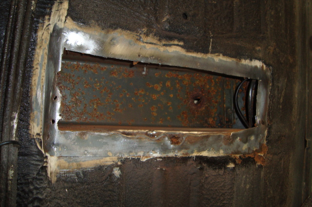

Left rear chassis section and floor pan. They've been cut and cleaned up but I am at the point of wondering whether I am better putting in whole new bits rather than cutting in sheet metal...

Tosh,
Have a look at K&k Mfg. panels.
They make a nice patch panel for that first pic.
Maybe a complete floor panel for the second pic?

« Reply #8 on: October 10, 2008, 06:25:11 »
Thanks naj
Derrick We4lls have the car at the moment and they have gotten me into this mess!
I am in discussion at the moment about the relative cost of new vs cutting in. Any opinions on here?

Heres my two pence.
For most panels i think its easier to remove the whole panel along the seams and weld a new one in its place.  You dont need to muck about with grinding an exact fit for the piece you're welding in.
Floor pans are relatively straight forward.  The rear chassis member is a bit of a pain though.  Why dont you just get a quote and go for the the complete pan if the cost is not substanually higher.  At least you will have a completely new panel with no rust on it.

« Reply #12 on: October 03, 2009, 18:25:35 »
So much of this depends on the extent to which something is rusted. Rusty stuff is fairly easy to remove compared to solid metal.
I would spot repair only if it was rusty in a certain smaller area. If the whole floor pan is rusty then it should be replaced as one piece. If a small area is rusty, then I would make a small patch and repair it that way. If the front section of a floor pan was rusty but the back was good, I might cut out all the rusty stuff and then cut the new pan in two using only the pieces that I need. It's kind of a 50% rule that I look at and as long as it will be a good repair when done, I'm OK with it.
In the case of the area that ties into the side member at the back end ( in front of the rear wheel ) I would make all of that by hand. You can buy a patch panel for that area but again, I would only use what's needed rather than cut everything out.
In the case of the side members or sills, if they're only a bit rusty front and rear but not really into the jack ports, I would spot repair those areas. If the whole bottom of the sill is rusted away front to back, then it's a matter of a lot of work. Don't let anyone fool you into thinking it's an easy job - it's not....
