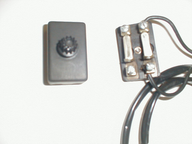

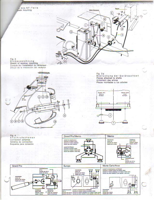

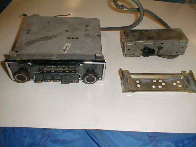

Hello William and Tosh,
Here is a good installation page sent to me from Ed Ebel at Becker. It shows the Becker Grand Prix Stereo installation. The mounting brackets, and auxilary fuse box with its mounting is also clearly shown. The power hook up for the antenna is also shown.
Download Attachment: Becker Grand Prix installation.jpg
77.39 KB
Download Attachment: aux fuse box 2.JPG
57.68 KB
The Becker Europa mono radios used most of the same hardware and connections (one speaker output of coarse).
Depending on the year of manufacture the Becker mono radios may not have the separate amplifier. The electronics got more compact in later years. The actual size of the separate amplifier box got smaller also. Eventually the radio tuner itself also became more compact. The face plate, escutcheon and mounting hardware remained the same.
The exception is the early radio Becker TR (230-SL)which installed in a smaller dash opening with an entirely different face plate and escutcheon plate.
The Becker Grand Prix with the signal seeking feature "wonder bar" mono or stereo, always had a separate amplifier box as far as I know.
Download Attachment: Becker Grand Prix Stereo 1.JPG
56.37 KB

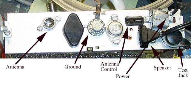

Could you do me a huge favour and post a picture of the back of the radio?
Mine is "in situ" and I want to connect it to a modern amp in the trunk.

Found the picture on Dorians site
Ot go to:
http://www.johnlivingston.com/becker_europa.htm
Download Attachment: Becker radio bagfra.jpg
21.16 KB
