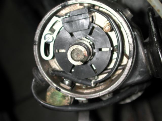

Well, yesterday was International Women's Day, and I had to desist working on the car and pay attention to the spouse. Today, things are back to normal, so I got back onto the Crane installation. Didn't get too far, sorry to say. While I got the smallest slotted disk to fit, thanks to Naj, I cannot figure out how to locate the pickup unit. Does it go near the brass pole or on the opposite side? Which of the two "L"-shaped supports is used?
Advice is, as always, greatly appreciated.
Joe
Re: Crane XR700 Question
« Reply #3 on: March 10, 2004, 02:49:47 »
Joe,
I used the smaller 'L' bracket.
I will try to post a picture later today.
Download Attachment: Crane.JPG
38.11 KB
Hope this helps.

« Reply #4 on: March 10, 2004, 14:20:42 »
Beautiful! Thanks, Naj.
I noticed you left your condenser in place. That will save time if you have to replace the points unexpectedly.
Appreciate the help.
Joe

« Reply #5 on: March 11, 2004, 03:53:23 »
Yep, Joe,
Theory is if you're prepared for it, it should never happen??
Note in the picture that the slot in the shaft for the rotor is a few degrees from lining up with the mark on the distributor body (@ 5 o'clock) and the slot in the disk (@ 11 o'clock) is similarly, the same few degrees away from the trigger center.
They should both line up at the same time - purrrfect timing  ;)
