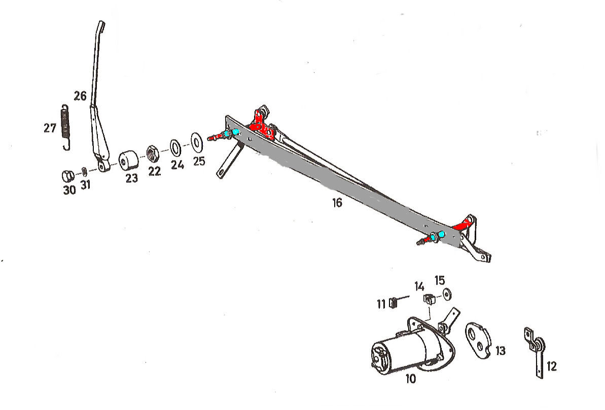

Sorry to hear about your trouble.  Here is a picture of the wiper assembly.   If the motor is disconnected from the wiper assembly you should be able to turn the wiper spindle back and forth to copy the motion of the wiper arm.  You indicate the wiper spindle is frozen.  The attached picture gives you some idea of what you are up against.  The silver colored bracket is bolted to the under side of the body.  Protruding through the body from underneath you have two hollow shafts which are represented in the color lt blue.  These shafts are permanently fixed to the silver bracket.  Behind the silver bracket you have the wiper assembly itself. It is shown in red.  As the wiper assembly rotates via the motor a right and left side spindle inside the hollow lt blue shaft rotate back and forth causing the wiper blades to move back and forth on the wind screen.
I suspect your problem is caused by friction of the wiper spindle as it rotates back and forth inside the lt blue hollow shaft.  This area is not often lubricated and has a tendancy to dry out causing a squeeking sound when the wipers are on.  You can try and lubricate the spindle and hollow shaft area to see if you can free it.  If you can't free the spindle much of the under side of the dash must be removed to permit access to nuts which secure the silver bracket to the under dash body.  The wipers arms and large nuts on the r and l shaft must also be removed.  Once this is dome you can push the wiper mechanism through to the uder dash side and take it out of the car for service.
I hope this is clear enough.  Let me know if you have any questions.
