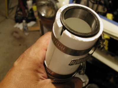

I figured that while I had my radiator removed for a recore, I would clean the 1/8" - 1/4" of sludge and oil that has built up on the outside of my engine.  I discover that the main front seal appears to be the main source of the problem.  During last weekends Blacklick event, I asked several people if they recommended replacement of the front crankshaft race that the front seal slides over and wears against.  While I was advised to replace it, I could not get any good ideas how to remove the race.  After thinking about it for a while, I came up with the following simple homemade tool that you can see in the 1st photo:
6" length of 2" PVC pipe with a 1" slot cut out down the 6" length
2 hose clamps
After cutting the slot in the pipe, I removed all the PVC shavings and cleaned the piece with soap and water.  You do not want to get little pieces of plastic in your engine.  I fit the 2 hose clamps over the pipe and pre tightened the clamps.  I slipped the pipe over the race which has about a 1 -3/4" outer diameter and tightened the hose clamps until the pipe was squeezed tightly around the race.  Using a large wrench on the outside end of the PVC pipe, I was able to loosen the race from the crankshaft and then pull it out with relative ease and no tool requiring metal to metal contact.
Once removed, the wear on the race is evident as you can see in the 2nd photo.  Hopefully once back together, I will have found the source of my leak and my engine will remain clean.

Congrats on the very elegant tool.

Clever tool  8)
I believe you can use the same race again 'turned around' for a second life.
