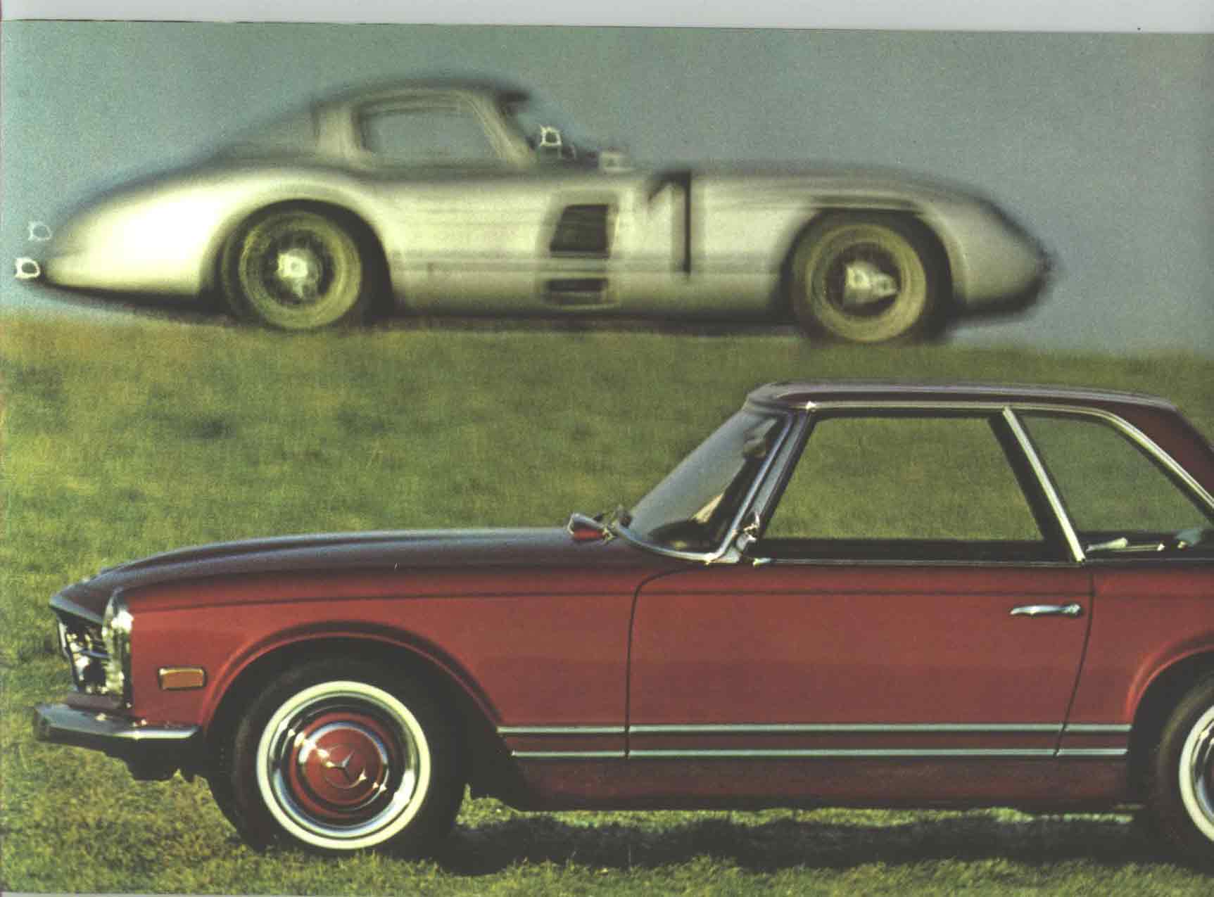

« Reply #5 on: November 28, 2005, 05:43:44 »
 :?: Did the color of the rocker change over the years?
Attached is a pic from a '68 brochure.  This picture shows the rocker painted the color of the car.
Download Attachment: 1968.jpg
72.71 KB
