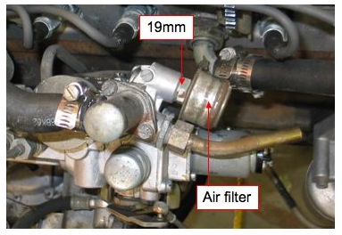

I'm concerned and afraid.  I've pumped out all of the oil three times now (at least it's clean now) and I'll refill and monitor it.   I assume from the postings and the two threads that replacing the seal that keeps gas out of the oil isn't a DIY job.  On a related note, the owners book makes reference to replacing the air filter near the back of the injector pump -- don't see how to remove it or what to replace it with.  Any comments?   Thanks, Scott

it takes a very narrow 19mm wrench (at least on my R11 IP) to unscrew the filter housing. Might need some soaking with PB-Blaster or similar to get it loose. Inside is a filter element that disintegrates over time. As far as I know you cannot replace just the element you need to replace the whole unit. It is still available from M-B.
However I would not worry about this now. If you have to send the pump for repair then Gus (or whomever you pick) can easily replace the filter if it is necessary.
