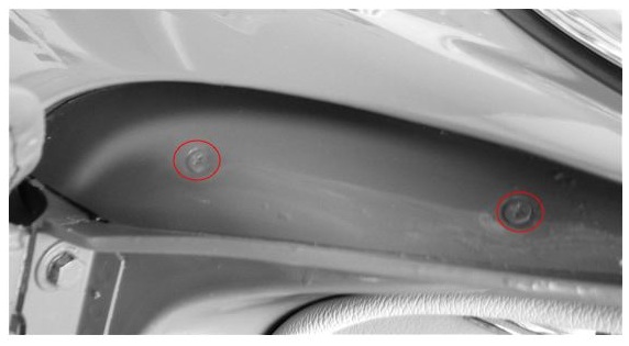

Originally posted by Douglas
... Go deeper. Look for filler with a magnet, look at proper panel fit, look for integrity in the body or the restoration, look for maintenance records, look for cars where the seller isn't trying to hide flaws,look for an enthusiast owner.... All of those are more telling.
And to add one more telltale to Douglas' excellent list, open the door and look at the space above the hinge.  On many cars you will see Phillips screws in the panel, a sure sign for past fender work.
