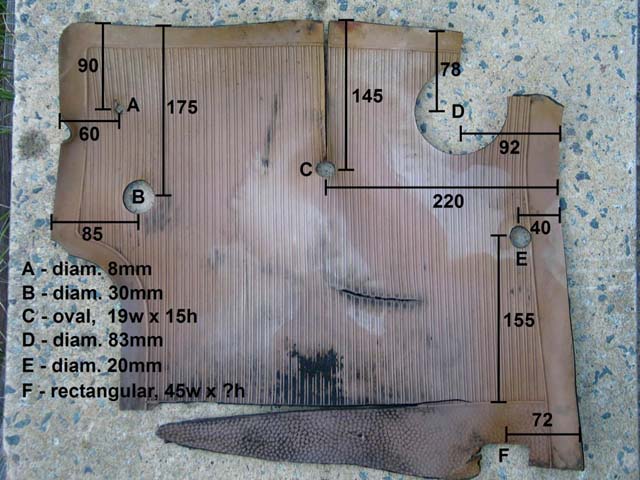

Here's some dimensions from mine (1965 US model lhd). I'm unsure of the correct dimensions for the accelerator pedal cutout due to the damaged mat.
Download Attachment: rubbermat.jpg
70.41 KB

« Reply #3 on: June 21, 2008, 12:36:43 »
Dave, thanks for the time to blueprint the mat cutouts for me.  They should be posted in the Tech manual for everyone since the mats do not come cut.  John
