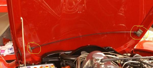

Ok just about got it. Remove these two: (after securing the torsion bar to the hood).
Once the hood is off is it possible to change the torsion bar pads and rubber buffers without messing up tension? [see pic 2.]

Yes, you've got it.  No, you'll have to relieve the tension on the hood prop to safely change the bits you've circled.  I have not done this or seen it done but I remember there has been some good discussion on this subject in the past.

Securing tension rod:
I use an S hook to hold the tension rod and connect it to the hole on the left side on the inside of the hood. The factory conveniently put the hole there for this procedure.
