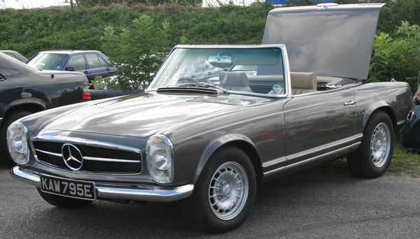

Here's a Pagoda on 15" (x7) alloys
Tyres 205/65x15.
Car is an early 250SL with 5spd ZF wow!
15 inch steel wheels probly came from a W124 or 126??

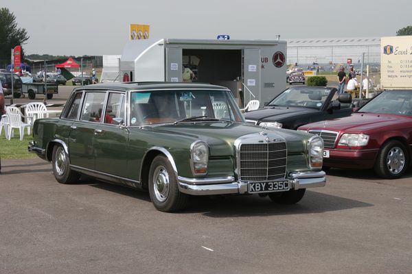

Interesting topic.  Was there ever a Mercedes-Benz model produced with 15" wheels and full (280SL style) wheel covers and are those covers available today?
Re: Which 15" steel wheels fit a Pagoda?
« Reply #7 on: September 20, 2008, 14:42:23 »
Here's one I know of:
