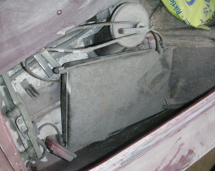

Getting ready to paint the car...so now I am looking into mechanical stuff...Since I got the car this has been in the passenger side of the trunk...what is it and where to all these cut lines go?
Thanks, Bob

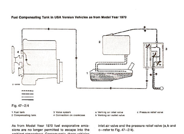

That is the fuel vapor compensating tank.  It is help in place on   the drivers side of the trunk.  Here is the info from the BBB.

That is the fuel expansion tank which will be placed on the left side of the trunk.  Close responses but Jeff gave more information.

Understand that we have two different things here, or at least two models.
1969 and earlier was a tank to accomodate expansion of the fuel in the main tank; it expanded into the overflow tank via vent lines, and the vapor (or fuel if the expansion was too great) vented to atmosphere via a small vent line from the expansion tank to the atmosphere; you can usually see this little pipe near the exhaust; sometimes it has a cone shaped end.  I've cut these open, there's nothing inside but the ends of three lines.  Two connect to the vent lines on either side of the filler neck where it enters the tank and the third vents to atmosphere.  Nothing else.
1970 saw (as the photo shows) the elimination of allowing fuel and vapor to escape to atmosphere (smog you know) and there was the secondary unit (were they all one??  I can't tell) that had valves and maybe internally, a carbon canister.  This kept the system closed.

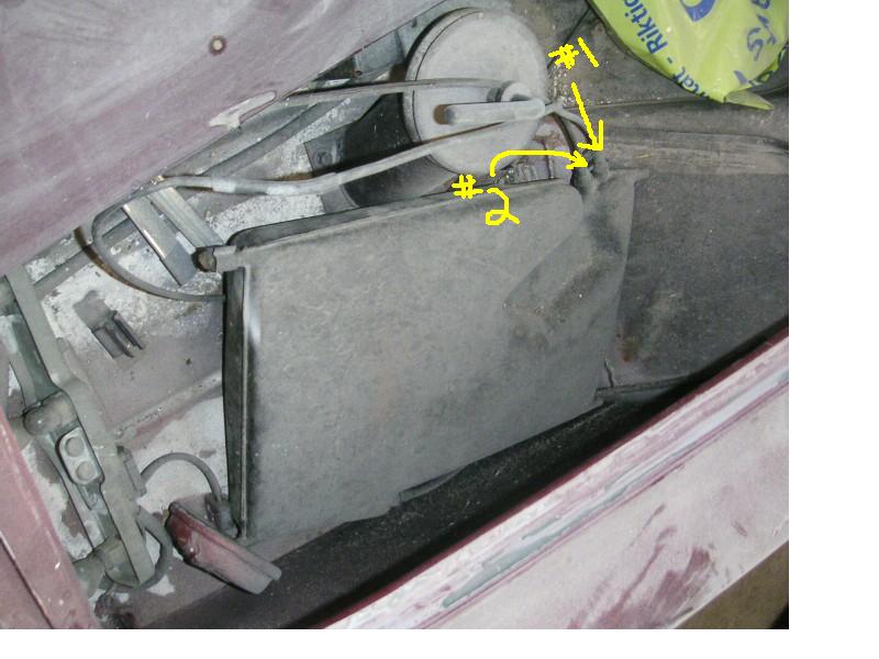

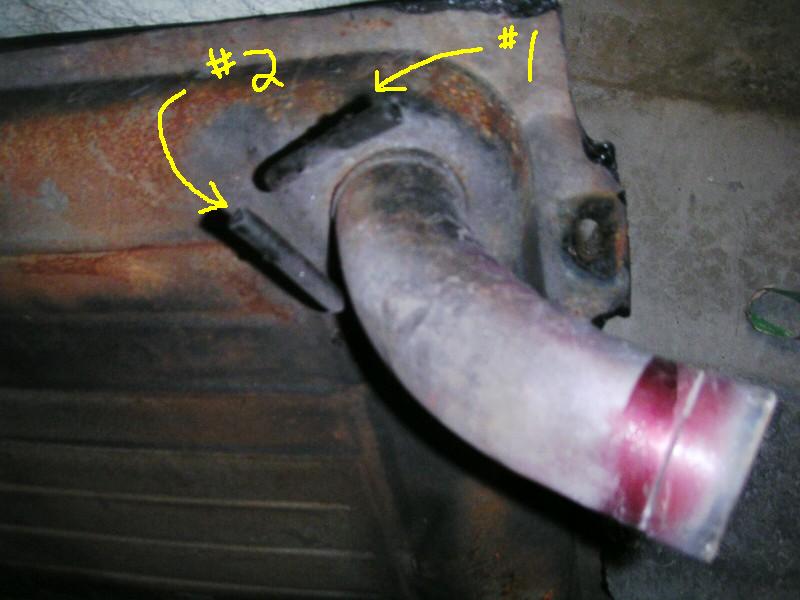

WILL GET MY GAS TANK BACK TOMMORROW just to make sure...The 2 hoses(GASTANK1A) will connect to the expansion tank on the drivers side trunk of the car. Why 2 hoses and does it matter which goes where?(GASTANK2A)
I know I am going to put the expansion tank on the drivers side, but what type of lines do I use to connect the ones on the gas tank to those on the expansion tank?
and then the bottom line on the expansion tank goes to this cone shapped device in the trunk that has a line that heads up toward the engine ...where does that line end? Could somone take a pix of where it ends(what it connects to?)
