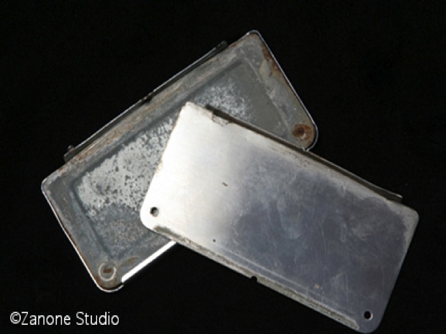

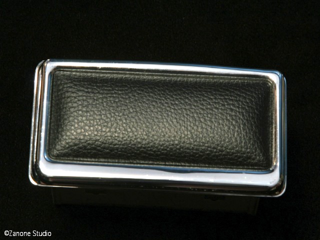

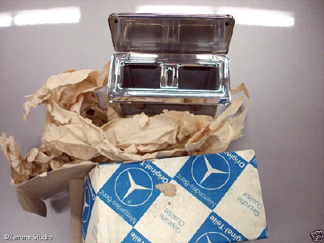

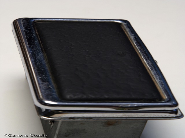

I found a NOS replacement ashtray on Ebay but I am going to try to cover my old ashtray in Parchment to match my interior when the material comes in from GAHH. If the cover looks good I will be selling the NOS ashtray, if not I'll sell the old one. Any tips on re-covering the ashtray will be helpful. Will move one into the For Sale category before going on Ebay so the forum will have a heads up.

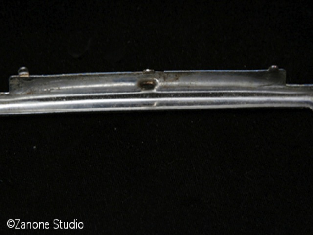

It's not a difficult process. That's not the issue. The metal is brittle and the clips tend to snap off when you undo them. I've done it twice now.

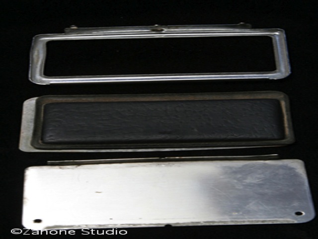

Douglas, I was able to use a small screwdriver and needle nose pliers to carefully lift the three pressure pins holding the plate for the four pieces and they seem strong enough to bend down again without breaking when the new MB tex is in place. The old pad seems to be one piece so I may be able cover it with the new parchment.
