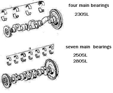

My guess;
All Mercedes engines of the era are very robust. Non of them were prone to failure because of their design. The  seven main bearing crankshaft looks like it is easier to balance and potentially had more capability to handle future power requirements.
It is a heavier engine  with more internal "drag" (friction) due to additional bearings.
Download Attachment: 231.JPG
24.11 KB
I would suspect that higher rpms as found in more modern engines greatly increases internal stresses. As I recal as rpms double internal stress increases to the third power! (cubed)
« Last Edit: November 21, 2007, 16:51:57 by ja17 »

Hello Paddy,
If you look at the massive counterweight in the middle of the four main crankshaft compared to the somewhat uniform balancing weights on the seven main, you will realize that designers had to be a little more radical when balnacing four main engines. In addition the flywheel and front balancers also had radical couterbalances to off set the spinning weight of two rods and two pistons between each
main bearing on the four main engine.
When you ever have a seven main crank assembly re-balanced they can simply balance each individual part or balance everything as a unit.
If you re-balance a four main engine the parts can only be balanced as a assembled unit.
Counterweighted replacent flywheels and front counterweights on four main engines must be matched to the old parts so counterbalancing forces are the same when replacing theseparts.
On seven main engines, since all the parts are symetrical and balanced individually and as an assembly, you are able to switch and relplace flywheels and front weights without any balancing.
Think of a crankshaft like a bridge, one with four supports (bearings) the other with seven.
