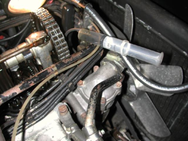

« Reply #11 on: April 03, 2007, 14:17:25 »
is there any way that you can see that it is possible to completely empy the master cylinder/res other than just turn the car upsidedown and shake?
Yes, use a syringe with a piece of rubber hose at the tip.
Here's one I used for another job:
Download Attachment: Hd-Bolt13.JPG
52.14 KB
« Last Edit: April 03, 2007, 14:30:02 by naj »
DavidBrough
Re: Intermittent Brake Problem
« Reply #12 on: April 04, 2007, 05:44:30 »
Hi James,
Naj’s suggestion is very good for removing the fluid but I would also suggest that you remove and fully clean the reservoir. It’s only held in by two rubber grommets and these are readily available from MB dealers. Mine was really dirty.
