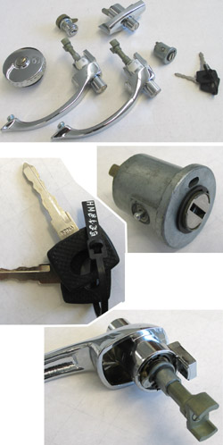

If you buy a lockset 113 893 0403,
you will get:
ignition barrell
glove box lock
trunk lock
fuel cap and
2x door handles
2x Key (mine did not come with the chauffer's key but then it was NOS)
All above work with the same key.
I have such a set but I'm not sure the ignition barrell will fit my '68 steering lock. With your '71, it should not be a problem.
