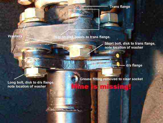

The rubber flex discs can deteriorate from age and/or use. Examine them closely for cracks in the rubber with cord showing. In advance cases, the cords will be frayed and sticking out from the disc. The danger is that after complete failure, the drive shaft, centering bushing or transmission can be seriously damaged.
Often times these are not installed correctly and they don't stay fixed. Make sure to study the installation diagram and use all the correct hardware in the correct places. Notice three of the drive shaft bolts are longer than the other three. The washers are always next to the rubber (one under each short bolt head and one under each long bolt nut, total of six).  The flex disc kit comes with all new hardware.
