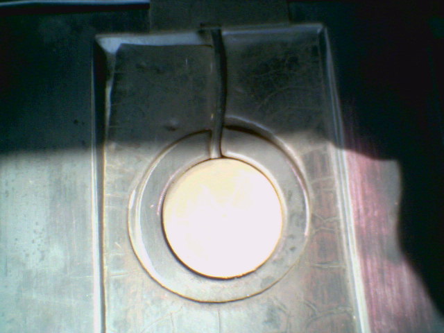

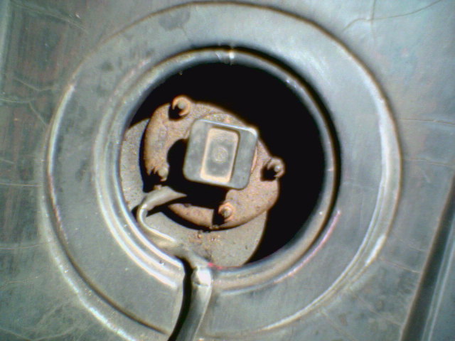

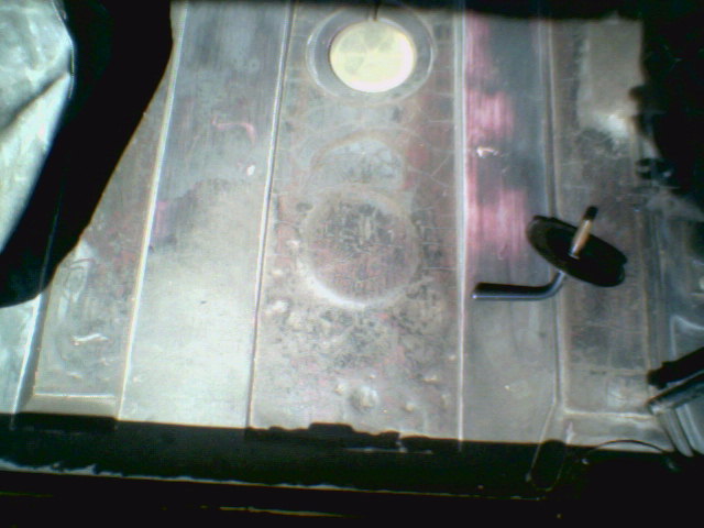

I have been working on my trunk.  I was sanding off the surface rust in preparation for thh primer and decided to take a couple of pictures of my fuel tank just to see what others thought and that it was all looking OK.  Here are the pictures.  I have the Haynes book and there is a black and white picture but have not seen another's trunk in much detial.  Just wondering if there is anything weird looking about it? Thanks...

Looks good.   These cars are famous for rust in the trunk.   My car's in the process of being repainted.   I went and visited my painter yesterday and he was busy sanding away on my trunk floor...

.... decided to take a couple of pictures of my fuel tank just to see what others thought and that it was all looking OK.
You don't get to the good part.  What counts is what's inside.  Did you look?

Did not look yet.  Reading all these threads on the gunk found, I think I should take a look but for now, I am focusing on rustproofing the trunk.  I spent 5 hours sanding by hand last weekend and then this weekend bought the sanding attachment for my drill to get ever last bit of rust out. Worked great.  Is is common practice to give the fuel tank a clean every so often?
