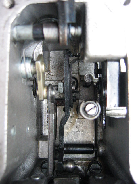

Hi Ricardo,
The broken parts in the picture appear to be: the lever, return spring, and mounting stud, that the cold start solenoid acts on to push the rack forward (see upper part of picture). Although not ideal, if the pump now rotates, there's no obvious other damage, and you've cleaned out all the debris, you could try running it again?  You've just lost your cold start enrichment, that's all.  Maybe you can still enjoy the rest of your "top-down" season, and worry about a rebuild in the winter!

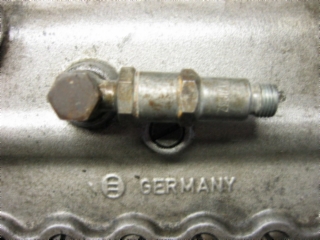

(Here's a pic. of the oil line check valve as well)

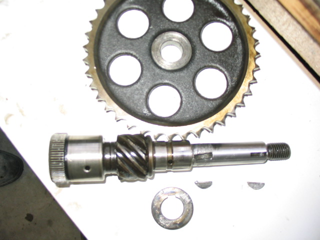

Ok It's some months later, but I thought I should do a final wrap up of this thread and share the results of the combined efforts to sort this one out.
The final conclusion from both Dan and his pump guy was that somehow I had one of those 1/10,000 type failures or that someone who previously worked on the pump had failed to properly locate the enrichment plunger that Will referred to and over time this piece became fatigued and broke. The governor mechanism was ruined but the plungers were fine and Dan's pump guy(Pat) was able to rebuild my pump using some parts from Dan. The main dist. drive shaft, part of a two shaft set, was actually twisted by the force involved and I ended up replacing both of these shafts and the large chain sprocket driven by the timing chain. Installation went well and I didn't have to pull the timing chain. I have put on approx. 5000 miles since and have had no further problems. This is in large part due to the great advice and help I received from folks on this list. I'll include a  photo to show the shaft damage. Note how the keyway in the sprocket has been completely filled by the metal shaved off the woodruff key....in fact it is impossible to tell where the keyway was!
