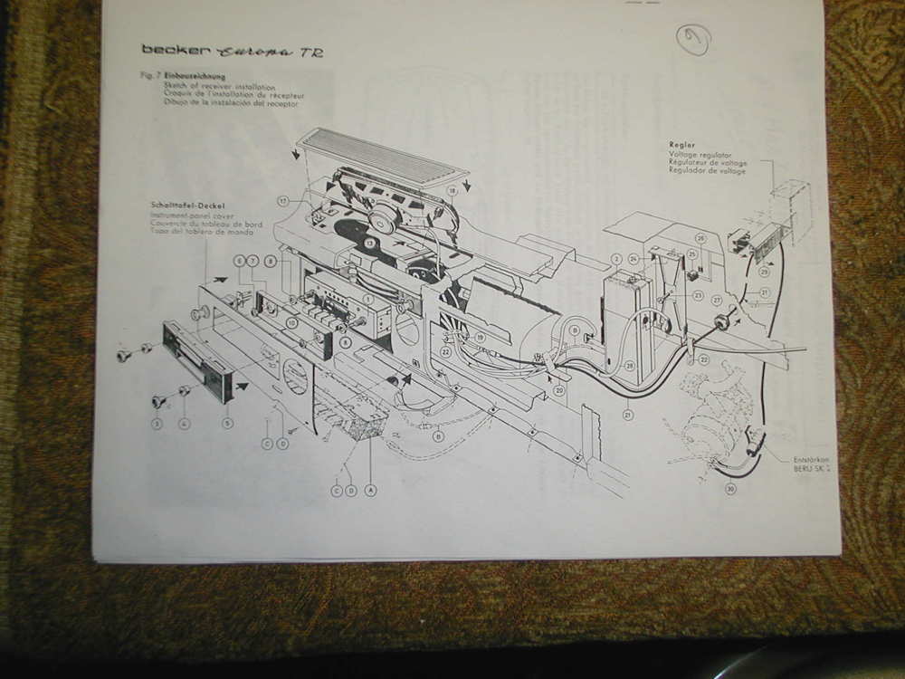

Re: Becker Europa with extra box? Stereo????
« Reply #4 on: August 01, 2005, 09:49:23 »
See if the attached picture will help you.
Download Attachment: Radio.jpg
81.48 KB

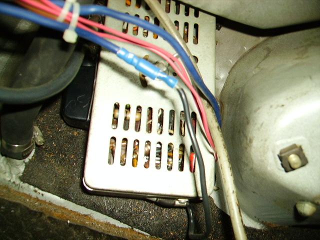

« Reply #5 on: August 01, 2005, 10:07:06 »
The prior posts have it right, you have an amp (with a whopping 3W Mono output!) that attached to the radio via din connector.  Here is a pic of mine in a '64 230sl, it is secured to the firewall above passenger feet with a single wing bolt (good luck threading the darn thing, it is blind)
Good luck,
g
Download Attachment: amp64.JPG
71.68 KB
