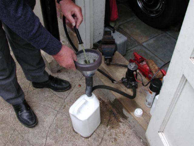

Re: Leaky fuel pump, help needed
« Reply #15 on: January 12, 2006, 03:12:46 »
Erick,
There's hardly any vacuum with air but if you prime the pump up with fluid (or suck the air out by mouth  :twisted: ) it will work.
