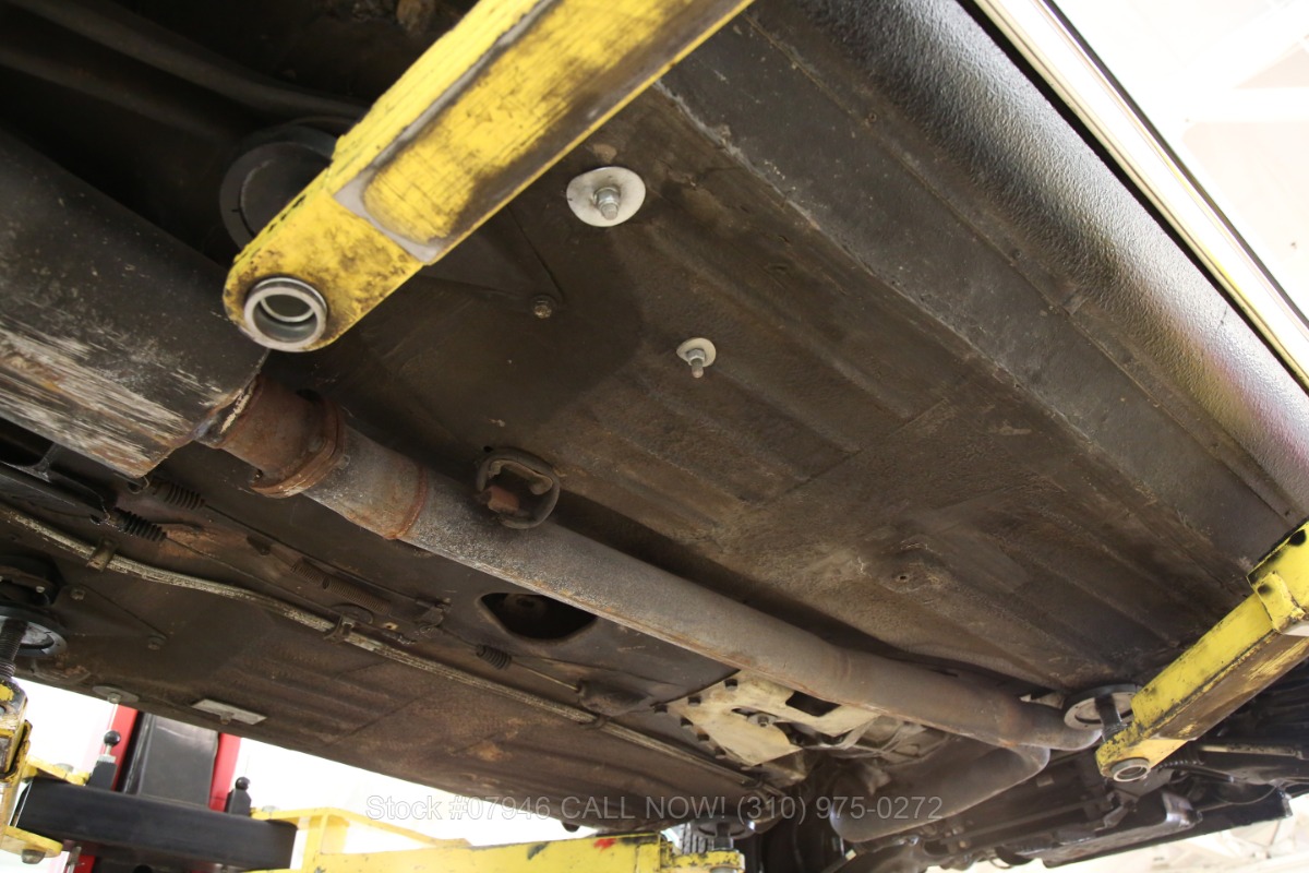

If the body is super solid, and has the ragtop, then $40k isn't TOO bad me thinks.
Looks decent to me (picture from BHCC):
Seat redo is easy.
The 5-speed sure is interesting.
I just wonder if it's a total hack job or done well.
Just poor presentation from the BAT no sale.
