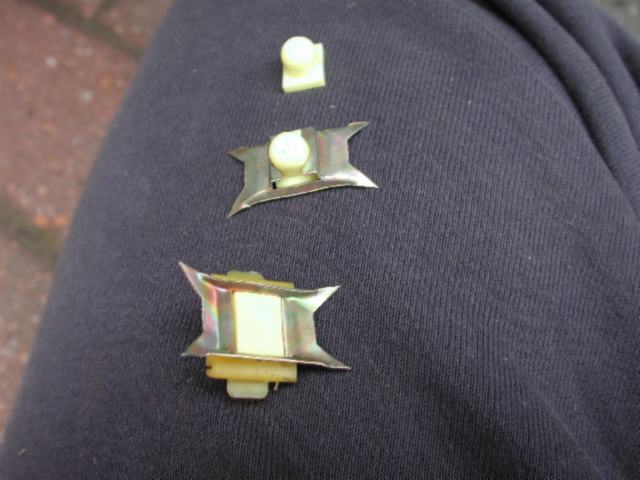

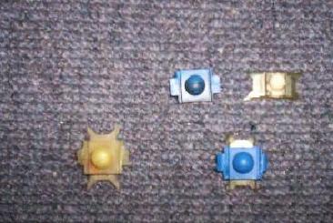

« Reply #7 on: February 22, 2005, 20:22:26 »
As promised... The one on the left is original. The two upper right combine to make the lower right... Resemble yours at all, Douglas?

Re: Question re lower trim strips
« Reply #8 on: February 23, 2005, 05:32:02 »
Is there any difference between the blue and yellow clips?
One may be for the door skin (much thicker) and the other for steel (thinner) panels?
Do we have a concensus on where the metal bit goes?
« Reply #9 on: February 23, 2005, 06:16:10 »
Mine are the top blue ones that are all plastic. (They also come in yellow, but they're the exact same thing.)

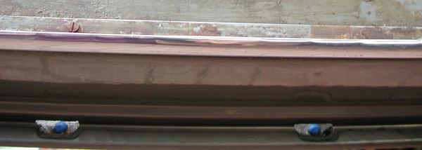

« Reply #14 on: March 26, 2005, 08:56:23 »

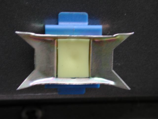

Here's what I did
« Last Edit: June 22, 2008, 10:52:02 by naj »
ranchomerced
« Reply #15 on: March 26, 2005, 15:31:36 »
I would recomend at least putting one of the spikes in every short piece and two in the door ones. I had one slide back and kink the door one and ruined the short piece when I opened the door to get out.

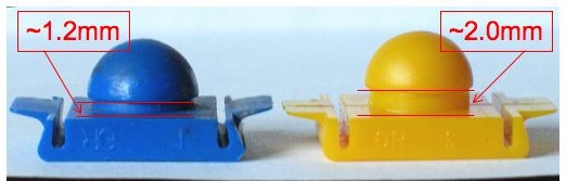

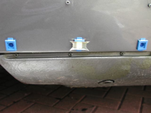

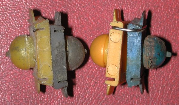

Hello, Alfred,
I believe the hole diameters are the same, it's just the gap in between the clip that is wider on the yellow clips.
In fact, I did manage to fit blue clips even on the doors on my 230 but the thumb was sore for a week or two!
I'll try and find some loose clips to show the difference.  Lower picture.
Now you need to teach me how to label these things properly!!  :oops:
« Reply #21 on: June 25, 2008, 17:56:08 »
Naj,
thanks that helped!
Finally I could notice the difference between the blue and yellow knobs:
Now I also understand why SLS only sells the yellow knobs in their clip set. Unless one has the "original" thin panels without layers of paint the blue ones are tough to get in - my thumbs hurt too!
Here is their description how to install them:
« Last Edit: June 26, 2008, 11:11:20 by 66andBlue »

« Reply #23 on: June 26, 2008, 01:57:35 »
Hello, Alfred,
Thanks for the pretty pictures.
The last picture seems to suggest that all the clips need the white plug to secure the clip to the panels.
If you look at the parts listings in an MB catalog, they suggest two each for the door panels and one each for the shorter trims - same as the spring clips. My view is that the white plugs are only used to hold the metal spring clips in place.
Any comments???
