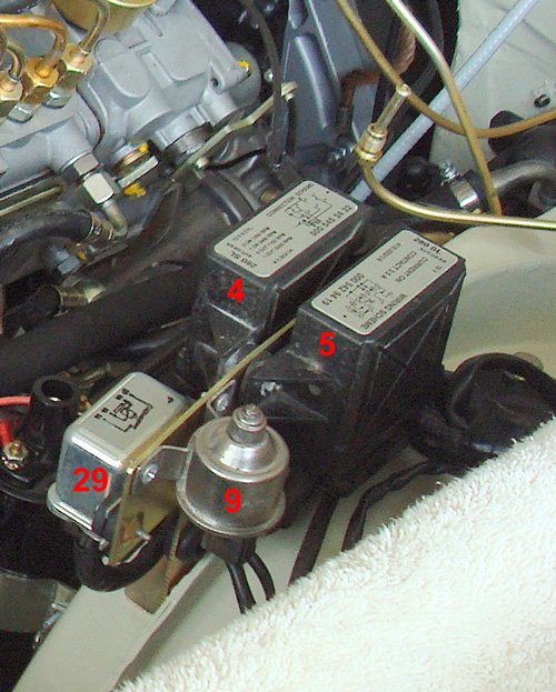

Can someone post pictures of this "switch gear" on the USA late models?
I have an 062 and just wondering before converting to the 123, whether to see if that stuff is all working or not. HOw to tell?

Very easy to tell if the late ignition system is working. Place your hand on top of the vacuum switch over valve and throttle up until you reach 2,500 RPM. You should feel a small vibration when it switches over. If you feel nothing, good chance it's not working.

Very easy to tell if the late ignition system is working. Place your hand on top of the vacuum switch over valve....
Is that #9 here?

Yup, number 9. It will click and you should be able to feel it. The click will happen twice; once as you pass 2,200 RPM and then as it passes that speed going down to idle.
