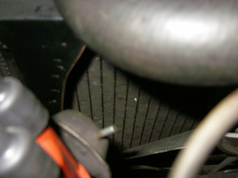

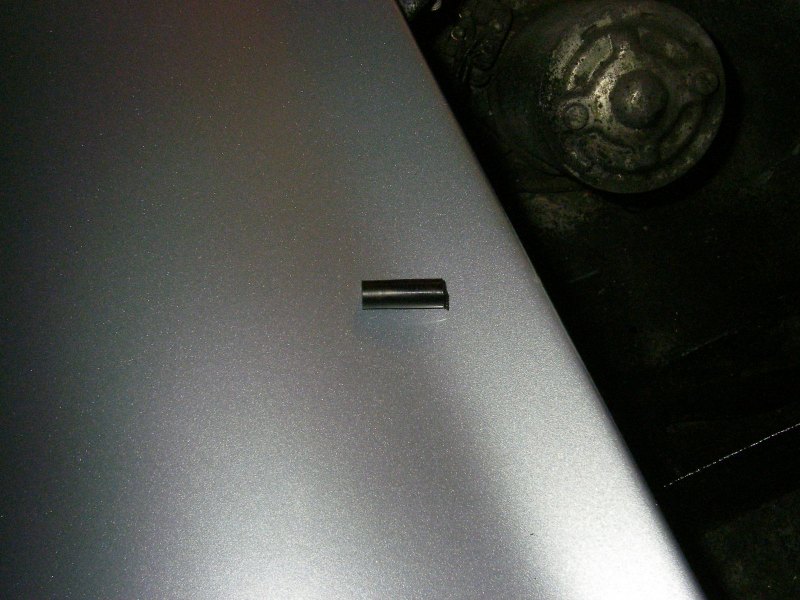

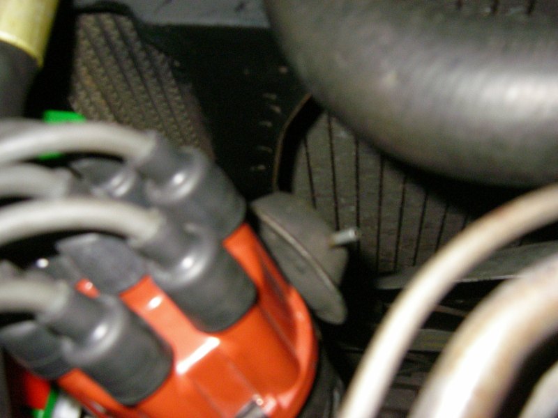

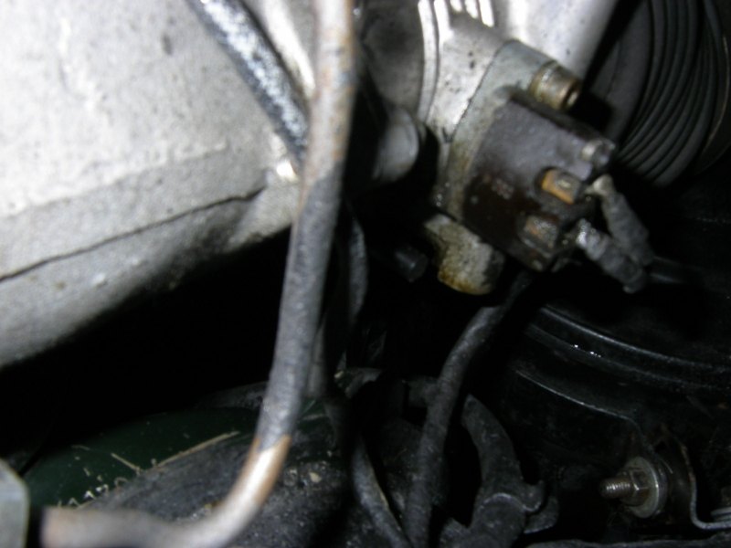

Anyway, here are some pictures of the vacuum port on the distributor and on the throttle manifold, along with the rubber cap found on the throttle port. It doesn't look as though anything has broken off on either side; they both look like short straight metal fittings that could take push-on rubber or plastic pipe.
The fact that there is a cap on the throttle manifold port makes me think this is no accident (although not restoring the vacuum connection later might have been??).

You're fine.  A temp fix is run a vacuum hose between the two.  The correct setup uses a white plastic tube for the majority of the route and rubber hose for the last few inches at each end.  With out the vacuum connected, the motor will idle up around 1300rpm.  with vacuum, it will retard the advance and bring the idle down below 1000.  And start your tuning from there.
