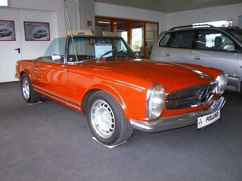

This would make for an intresting set up. I also believe would make for a tremendous change in stability.
Download Attachment: 280with 15inch wheels.jpg
27.63 KB
I've wondered if 15" alloys were available for the W113.  I assume these are off a W108, W114 or W123?  Anyone know the part number?
  • Posts: 7310
Re: Anti Sway Bars, Handling Etc. for Discussion
« Reply #10 on: July 26, 2004, 08:16:20 »
The 15" wheels sound interesting; with the right profile tires they would have the dual effect of lowering the car and reducing body roll caused by flexy sidewalls on our tires--both things reducing body roll that the sway bar attempts to keep in check.  My guess is that it would be a pronounced improvement.  Speedometer would most certainly be somewhat inaccurate for what that's worth...

I have the aluminum rims that allow the use of the traditional hubcaps and can attest to the improved handling and improved off-the-line performance that the lighter rims provide.  This is a little discussed improvement that all pagoda owners should explore.
« Reply #16 on: July 27, 2004, 22:11:33 »
Yes they are a great improvement. :D  I was surprised that I did not find any discussion on this. Once the hubcaps are on no one can tell the difference. 8)
I have posted the #'s of this wheel at the "Photos From Hauser" in the gallery section.

Hauser .... No, I still have the steel wheels on my 230SL.  I do have a couple of sets of the aluminum disk wheels that can be used with the full wheel hubcap but since my 230SL has the small hubcaps, I still use the steel wheels.  I also have a set of 280SL full disk hubcaps but they just don't look correct on a 230SL.  Some of my 190SL friends have installed clips on the aluminum disk wheels for the small hub caps but the holes around the circumference also doesn't really look correct in my eyes.
Jim Villers
Jim Villers
« Reply #18 on: July 28, 2004, 10:58:01 »
So sorry Jim, I was thinking about "Pea Soup."  For some reason I thought that Robby Ackerman's car was yours.
I completely agree that the round holes would look strange if left uncovered.

Hauser .... For you and others, here is a picture of the aluminum wheels. http://www.190slgroup.com/tech/images/rob_car2.jpg
