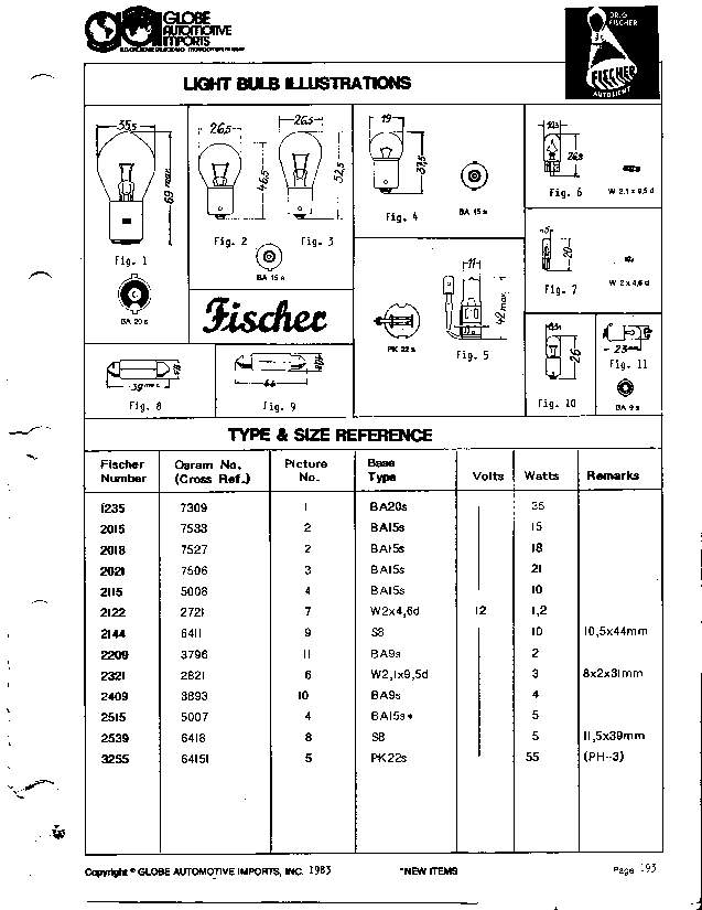

Hello Dana,
Give Ed a call or email him at Becker. He is very helpful and a great enthusiast. Becker was kind enough to contribute three new original W113 radio speakers and some other items for door pizes to our group at the Blacklick Ohio Tech Session last summer. Be sure to mention our group. Here is some information;
Becker Automotive Systems USA - 16 Park Way, Upper Saddle River, NJ 07458 beckerautosound.com (201) 327-3434 (888) 423-3537 (201) 327-2084 Ed Ebel classic Becker car radio parts and service
Download Attachment: Mercedes light bulbs.jpg
