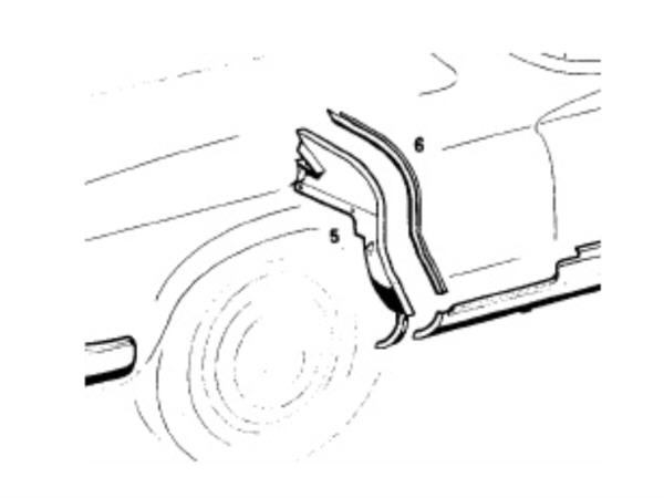

The side rails of the car are hollow.  A rubber gasket is mounted on the splash guard to prevent water from passing from the tires and road surface behind the fire wall.  If this gasket is dry and broken water can easily infiltrate behind the splash guard/firewall seal and enter the hollow cavity of the frame rail.  Do a search on splash guards for more information.  Here is a pic of the part.

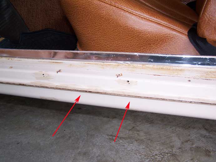

My guess is that the water is in the rockers.  There are small drain holes on the undersides (one front, one rear) where the water drains out.  If these are plugged, water will remain in the rockers until it evaporates.
Here is a picture of my rocker when I had my rocker panel off for painting, and was replacing the rubber door sill covering.
