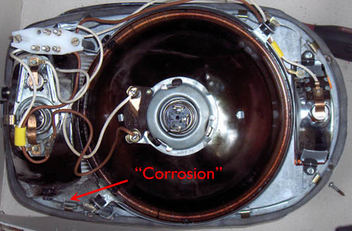

I first suspected that the removal of the side-markers may have had something to do with this. Inspection and checking the tail-light and headlight assemblies showed this not to be the case.
I narrowed it down to the left front headlight assembly. I removed it and when the assembly is out of the car, everything works fine (indicator, relay does not get hot etc). I usually suspect bad ground leads in this case, or faulty wiring in the cable coming through the fender to the headlight assembly. I checked it all carefully, cleaned the contacts etc. Then I reinserted the headlight in the car, and noticed that the blinker stopped working when I moved the assembly straight up to the fender. In fact, when trying to screw it in, sparks would appear at the lower left screw.
So in essence 12v was available on the metal headlight assembly surround, leading to a short when inserted in the car. I think that this points to a faulty ground connection, or a short on the headlight assembly. I initially tried some duct tape taped to the inside of the light receptacle in the fender to prevent shorts there… but that did not work.
I could also see that the metal headlight frame has some “corrosion” on the inside of the frame… or oxidization, I do not know how to describe it exactly, but it does look like there has been an electrical process going on for a long time at that point (which immediately made me think…. And what does a current at that point do for rust around the headlights… where many of our cars suffer it commonly). The rubber ring was fused to the metal too at that point… probably because of constant current.
I then had a look at the light-assembly on the right hand side. When the blinker was blinking, I could not detect 12v on the light-assembly metal frame. I removed that assembly to compare it with the one on the left hand side. When I did, I could see that the wiring loom had been spliced in the right hand fender, and an additional ground wire had been connected between the connector ground wire that attaches to the assembly, and the metal of the fender.
I drew the conclusion that after painting the right and left light assemblies had been reversed, leading to this indicator problem, and that a previous owner had solved this problem by improving the grounding.
So I switched the headlight assemblies, went through the procedure of inserting the assemblies with the blinker on (to see if shorting would happen again). At this point the light assembly fell out of the fender (don’t ask !) so now I have scratches again on the paintwork under the headlight, @#*~!

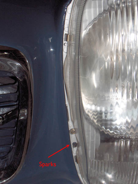

Initially that appeared to do the job. I tightened the assembly in the fender, and then went on a little shakedown drive (nothing like driving a few speedbumps here in Holland to ensure that all contacts get made or loosened, as required). And after 15 minutes, the same indicator problem appears again, but this time on the right hand side of the car (i.e. the same light assembly, as I switched them).
Again… no blinking signal, as it is shorted. The flasher relay gets very hot. The green indicator light dims when indicating.
I used an ohm meter to probe the assembly. The problem is that the blinker light is of course providing a permanent connection (with a resistance of only a couple of ohms) so it is very hard to find if there is a short on the assembly, but as far as I can tell there is not.

I suspect the problem is with the path of the positive blinker wire. There are only three places where this wire can be shorted to ground on the assembly (assuming it IS the assembly at fault, which you seem to have verified):
  • The connection to the blinker-bulb
  • The wire going from the blinker bulb to the main connector assembly
  • The main connector assembly
First, I would lift up the sprung-metal positive contact to the blinker light bulb and then try to measure continuity (using the ohm-meter) with the assembly removed, of course. If there is a short to the frame (between the wire or the main connector), it should show up. If not, then the point of contact at the bulb is suspect (it may be shorting to ground in a very subtle way, eg. around the bulb base). I would inspect that area closely.
Next, (if the short is indeed upstream of the blinker bulb) unscrew the connector assembly from the frame and inspect the turn-signal solder/connector for something obvious. (or very closely-spaced loose wires)
Sometimes, wire insulation is cracked and only 'opens up' when the wire is bent (under pressure: headlight placed in fender socket)... so I would closely inspect the blinker positive wire along the entire length from connector to bulb base.

I would remove the little dim light that illuminates the main beam bulb holder.  Think the problem lies in there.  Then isolate the contact from there and recheck the blinker.  I grabbed your picture and added some red circles.  Look at these areas and see if there are stray wires or so coming out.  Also tuck in the two wires from the blinker to the socket at the bottom.  Wires should be snug inside a small channel running around the main bulb holder.
There should be no sparks coming out from anywhere.
If there are sparks then the ground connection is weak, and is trying to ground where the sparks are.  Or you have a positive feed to the headlight assembly.
Another thing to check is the plug prong order on the socket from the body to the headlight, maybe the wire order is incorrect.  Sometimes, and it does happens, when pulling the plugs off, the back locking cover pops off and the wires pull out.  So check the wire order again.
Hope this helps and let us know of your misses/success.

… and it does work, right until I tighten the screws… and then the sparks reappear, the blinker relay is overloaded and then: nothing.
Is there a rouge wire tucked behind the head light bucket where the screws go into the body?

This sounds similar to a problem I had with the rear license plate lights. I saw that they were out, and checked the fuse, etc. When the lights were sitting in the trunk (not screwed into the body) they were fine, the second I tried to put them in place, a flash of spark and the fuse blew. I even tried using the black electrical tape to isolate them from the body metal, no luck. The problem turned out to be a crossed wire in the connector, current was shorting out since it was not supposed to be there in the first place! In your post you indicated you checked the connection, could a pin have been misplaced during the indicator light removal process??
