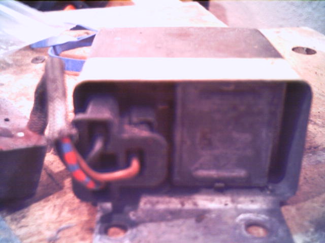

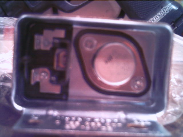

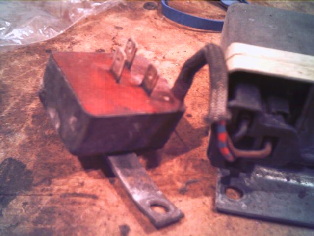

so, purchased a new voltage regulator from k n k.  when I pulled the old one out, there is another item plugged into the regulator.
it has a plug on one end for the voltage regulator, a small square box then a connection to the wiring harness.
does anyone know what this is?  there do not appear to be any markings on the box.

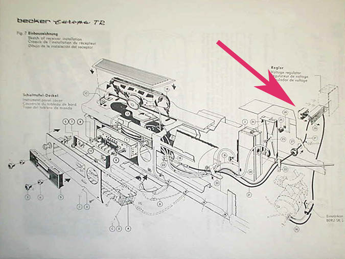

It is a Fuse Box, probably, and it was used for the original Radio wiring noise suppression. the Wire coming from the Harness should be Red/Green and the Wire from the Fuse Box going to the inside of the car was Black, this set up was wired to the Ignition Lock position I for Radio use without turning the Ignition on all the way. Early 230 SL did not have this set up.

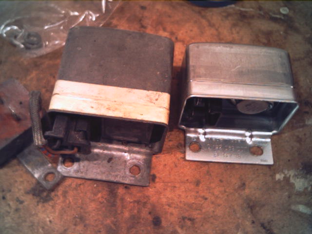

oops, in this post and the one below I have attached some photos for review.  I still do not konw If I need to use the suspect item with the new voltage regulator or not.

Matt, you should have three wires that plug into this thing, originating from the main harness.
Re: what is this plugged into voltage reg
« Reply #7 on: January 24, 2007, 09:35:39 »
I have never seen this extra box wired into the regulator circuit of any Benz that I have ever worked on.
This same voltage regulator was used on most european cars of the same era with Bosch electrical systems. So it could be for one of those non-MBZ applications.
My guess is that it is a balast resistor to change the voltage output of the alternator above (or below) the setting of the stock regulator.
I would leave it off.
The terms "internal or external regulator" refer to if the regulator is mounted directly on the alternator (internal) or on the fender well (external)
Al

If one wished to keep the original look of the larger case, can the contents of the new voltage regulator be transfered to the old case?  OR.....would this be opening a big can of worms?  :evil:

so, i finally broke down and sent gernold an e-mail for help.
below is his response
that Box is part of the Radio noise suppression system,
either use it as was or don't use it at all, it will depend on what Radio you are planning to use,
Hope this Helps and Good Luck with your SL,
Gernold

Try doing a charging system voltage test with the small box installed and then with the harness attached directly to the harness.
Try running the motor at 2000 rpm with a volt meter attached to the battery. With all the power consumers turned off it should read at about 13-13.5 volts. If there is no difference with the box connected I would see no reason it shouldn't be left attached in the circuit.
I would be interested to know if the voltage reads higher, lower or has no effect with the extra box attached.
Another possibility would be that the box is a noise filter for the radio instalation.

Got it!...Thanks Al. I just tested things.
The numbers with it and without are almost identical. A smidge less at idle (both battery and ballast resistor) when the bugger is not in the equation. So I think I'll leave it off. Last question -- I bet you and Gernold are correct that it is a radio suppressor thing -- will this now effect my radio with it out? It's not the original radio (although it is a Becker Europa II).

There was a Becker radio I think it was a Grand Prix series that had 5 bands and the extra filter was for one of those frequencys, not the AM (K) or FM (U)
