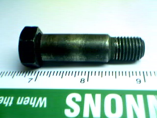

I found this bolt (see pic, dimension of bolt is in inches) on the driveway late this afternoon.
Download Attachment: bolt_3.JPG

This bolt looks like it fits through a bush or something because of the long shaft and short thread.

Flex disc bolt?
  • Posts: 7503
Re: Pagoda mystery bolt?
« Reply #2 on: January 24, 2007, 06:11:35 »
Hello Bob,
I agree with Naj here. It looks like a flex disc bolt. Do not delay here. You can do a lot of damage to the flex disc, drive shaft and even transn=mission if the situation is left undone!  You'll need to pick up at least one new 19mm head nylock nut (locking nut) and a special washer by the looks of things.

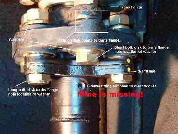

Hi Bob,
Flex disk!  See attached pic.

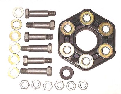

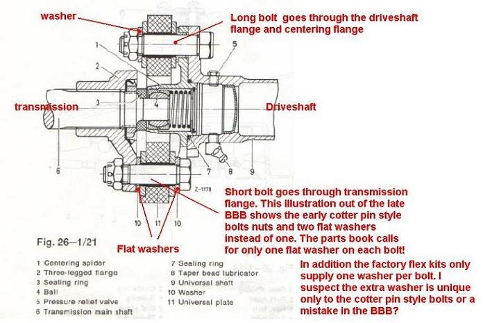

Since these are shoulder bolts, the nut actually bottoms out on the shoulder during tightening.  This prevents the flex disc from getting squeezed too tight. It the washer is left out or the incorrect thickness is used then the "tightened dimesion" will be different. In other words if the washer is thinnner or not installed the nut and bolt will tighten before the flex disk is snugged up. If too thick a washer is used or too many the flex disc is squeesed too tight or the nut does not bottom out on the shoulder. Look at Bob Possel's Flex disk post. It shows good pictures of the correct installation of the assembly.
There are three long bolts and three short bolts there location is specific and the arrangement of the washers is different on the these.

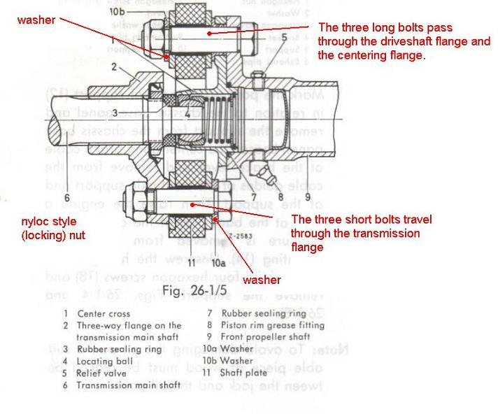

Bob possel's photo below shows correct assembly sequence.
Download Attachment: bflex.jpg
35.89 KB
In addition the early BBB has a good correct illustration of the assembly.
There are some problems with factory documentation here. For some reason my early BBB which is a later reprint shows the later nylock bolt arrangement correctly. My original late BBB shows the early cotter pin arrangement with an additional lock washer on the short bolts!?
Here is the late nyloc style in my early BBB reprint:
Download Attachment: eflex 20.JPG
84.57 KB
Here is the early cotter pin style in my orig. late BBB
Download Attachment: late 10.JPG
79.32 KB

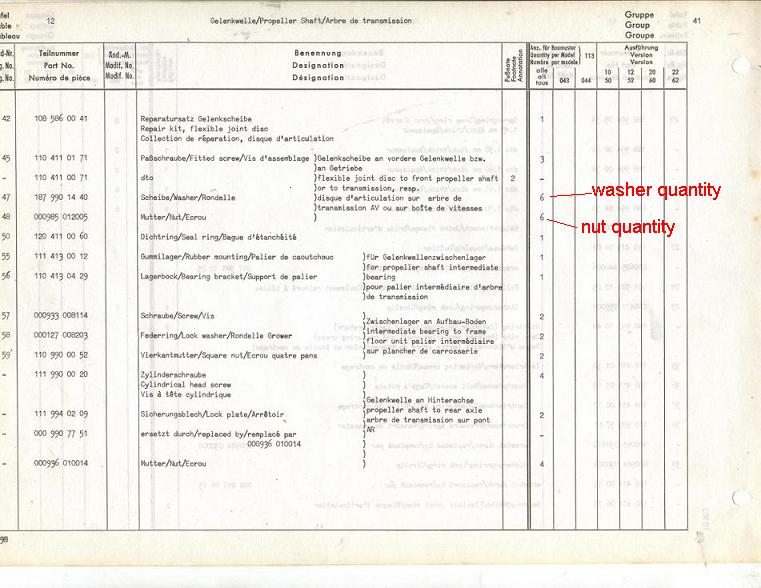

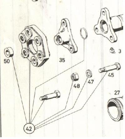

Refer to the dealers parts book which calls for only six washers, one on each bolt.
Here is the dealer diagram in the parts book showing just the different parts and not all the parts.
Download Attachment: parts 1.JPG
53.65 KB
The text in the dealer parts book calls out the quantity  of same parts in the right column.
 Download Attachment: parts 2.JPG
81.84 KB
