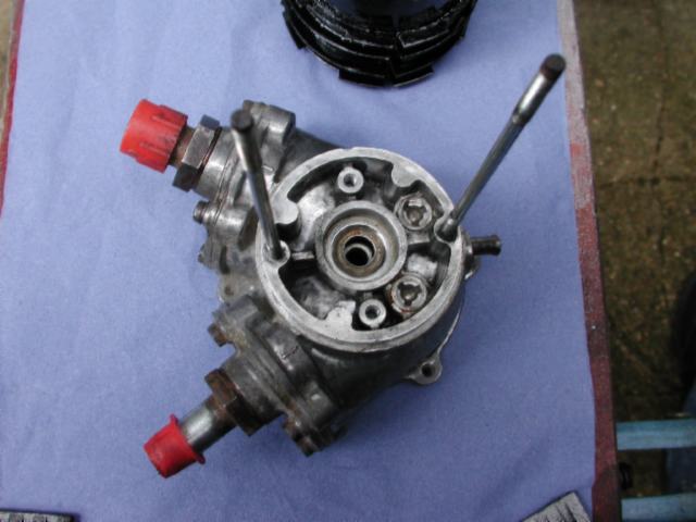

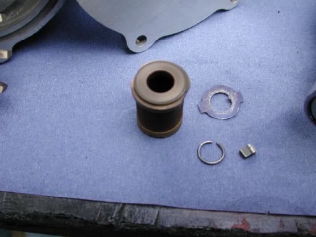

Some pictures showing items George Des has been explaining.
(Pump was rebuilt with his instructions and also help from Brisbane Bob)
Download Attachment: EFP07.jpg
38.1 KB
Download Attachment: EFP06.JPG
36.17 KB
Download Attachment: EFP01.JPG
36.37 KB
Hope they are useful
