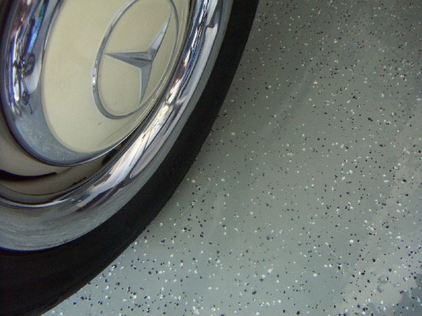

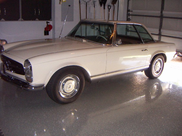

This might have qualified for the "photos" forum, but I am so pleased with the outcome, I just had to share...
After completely overhauling my garage in anticipation of my "new" 113 three months ago, I was a little dismayed by the appearence of the floor. Low and behold, the local Home Depot just started doing applications of Rustoleum "Epoxyshield" garage floor coatings. $2.50 per sq ft installed!
Kevin
PS Sorry the car is a little fuzzy...new camera, too!

What a steal ...
I am not only jealous of your new garage floor but also of the location it is in (I lived in Boca for about 4 years ...)

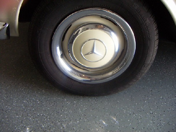

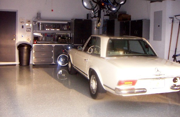

Not that I have Home Depot stock or anything (wish I did 10 years ago!) but here's what you get for the "installed" price: Floor is roughed/cleaned with an abrasive wheel on what looks like a buffing machine. It has an attached vacuum bag so no dust. They roll on a primer/adhesive, let it dry then apply the epoxy mixture with a large squeegee. As the coating sets up the specs are applied to give some skid-resistance. About 5 hours from when they arrived to when they left.
Kevin
