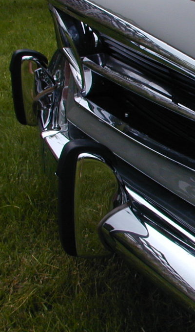

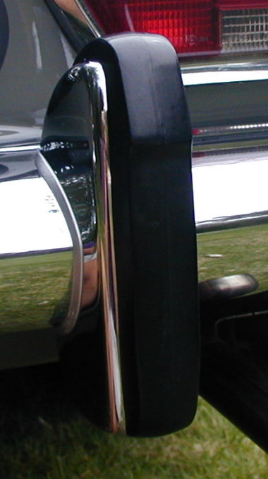

Here are a couple of pix of the finished product:
Download Attachment: guard.JPG
48.1
KB
Download Attachment: guard2.JPG
63.08
KB

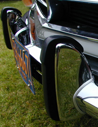

And here's the front bumper before (too bad you can't see the backside):
Download Attachment: guard3.JPG
69.01 KB

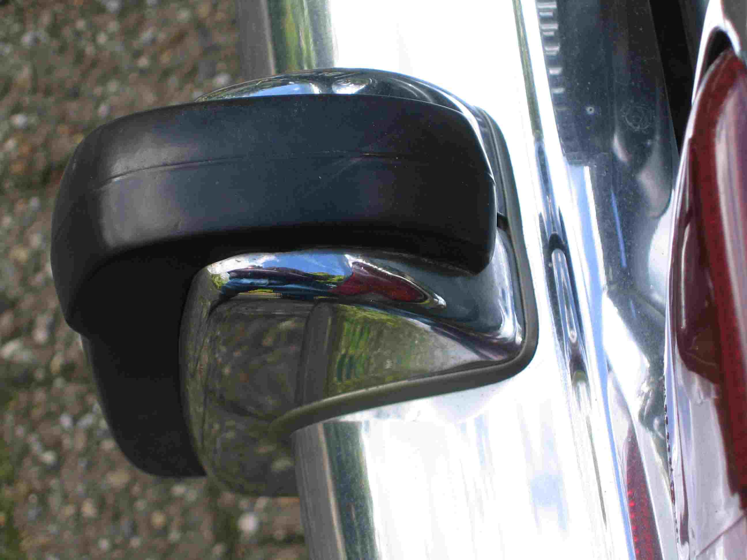

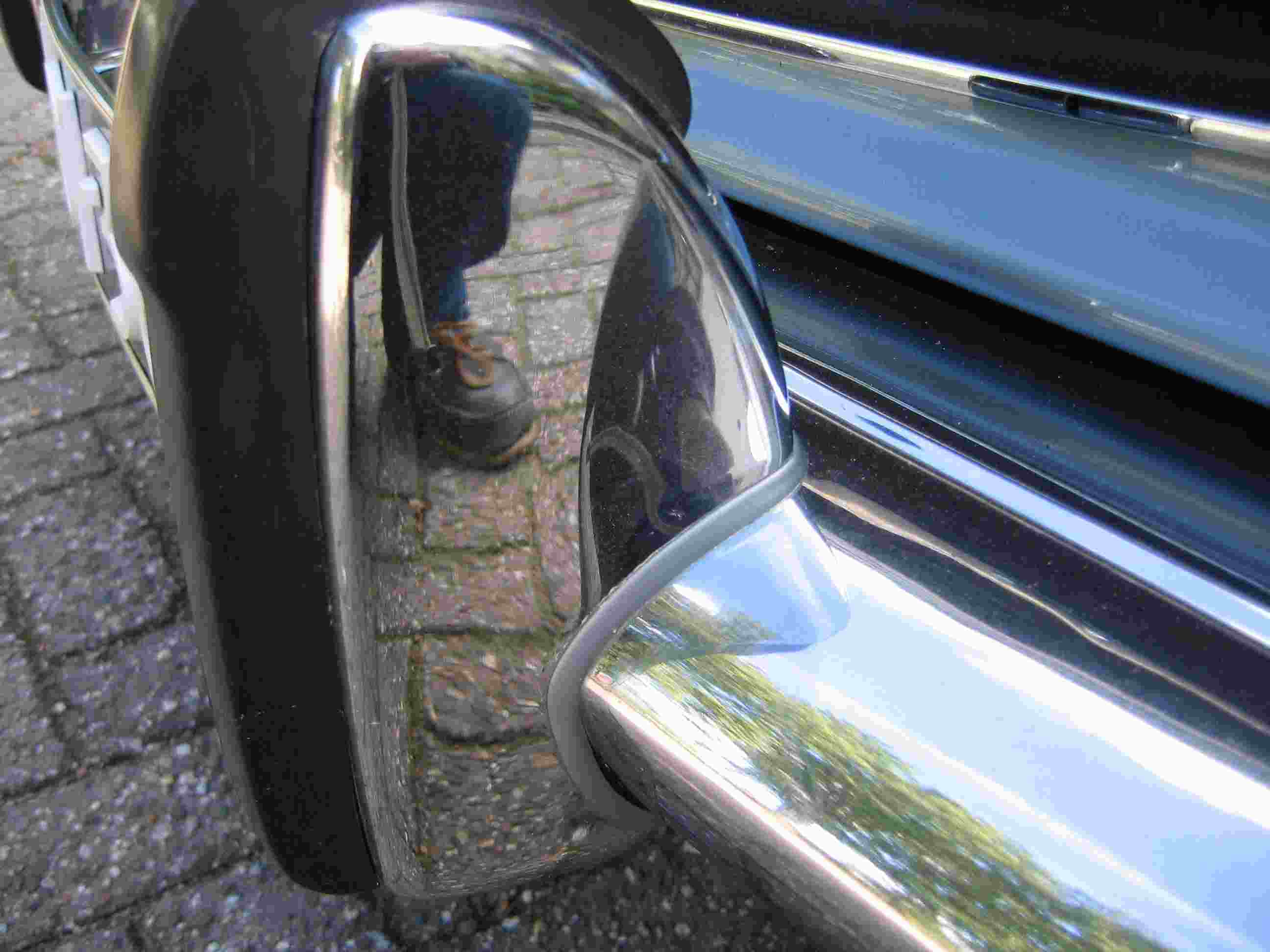

« Reply #9 on: September 25, 2004, 15:05:32 »
Doug,
I bought original siver collored gaskets at sls Hamburg last year. Mine originals were totally hardened and could not be glued anymore. I will take a pic and post it.
Gerard Wuisman
1970 280sl
gwuisman
  • Posts: 184
  • Keep it simpel
Re: Bumper Guards - I had no idea
« Reply #10 on: September 26, 2004, 14:19:05 »
Doug,
Here are my pics.
Gerard Wuisman
1970 280sl
Download Attachment: front guard gasket.jpg
75.56 KB
Download Attachment: rear guard gasket.jpg
