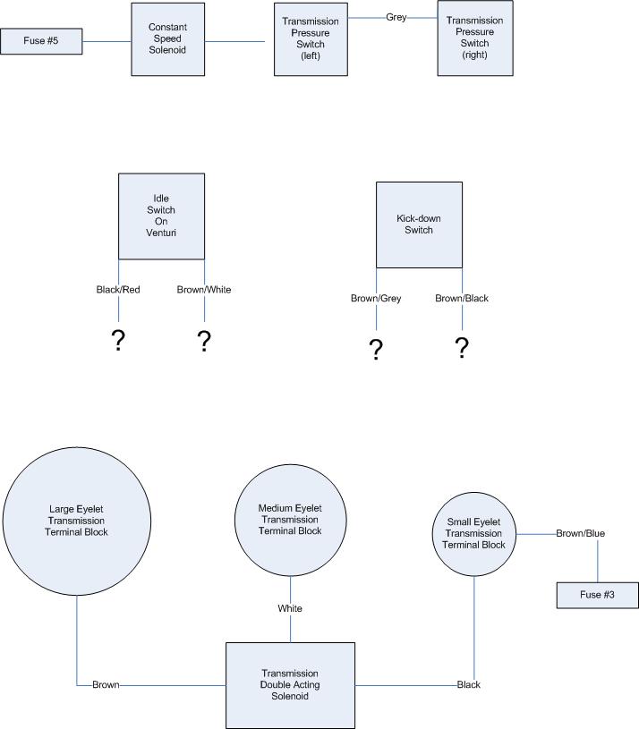

Thought that I would open a new thread on this...
From what I have read, here is what I think the connections on the auto transmission (idle switch; double acting solinoid; Constant speed soliniod; pressure switches) should be.  I know this has been hashed many times, but maybe we can do a final and accurate drawing for the manual?)
Can someone who knows this wiring please review and update my drawing as needed.  Also tie in the question marks to there proper connections?
Thank you!  Bob  :)

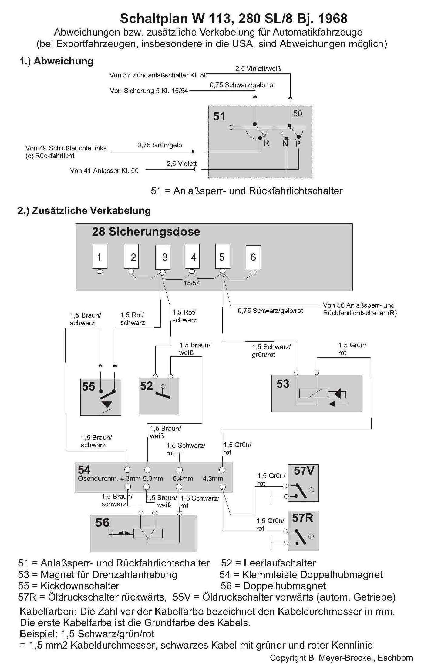

Hi Bob,
awhile ago BMB published this wiring diagram on the German web site. Perhaps it is of some help to you. [I tried to make the pic smaller but could not]:

Thanks Alfred!
This should help!
I'll relook at this today and give it another try this evening.
Regards, Bob  :)

We're getting closer!  Need a definitive total wiring diagram and a written description of how it's 'sposed' to work.

In summary, my electrical issue was caused by 2 things: one of the horn connections touching the frame of the car and causing a short; also, I installed one of the kick-down switch wires to the left side trans pressure switch.  This wire should have been installed on the small eyelet terminal on the side of the automatic transmission connection block.
Unless someone has redone the wiring on the auto trans connection block and incorrectly replaced the 3 different size eyelets, you should be able to just connect each wire based on the size of the eyelet to the size of the corresponding screw on the terminal block.  This is what I did.
Where you may run into an issue is with the wire for the constant speed solenoid device.  I dont have this and not sure what size eyelet it may have?

Alfred's diagram below most closely resembles my setup, with the exception of the constant speed solenoid which I dont have.  So my pressure switches are tied together with the single wire that crosses over the trans hump, but they sit there lonely in the end and no wire connects them up to anything else... :( .  I also didnt understand the terminal block on the diagram.  It appears to have 4 connection points.  The terminal block on the side of my auto trans only has 3 screw connection points.  Another mystery?
