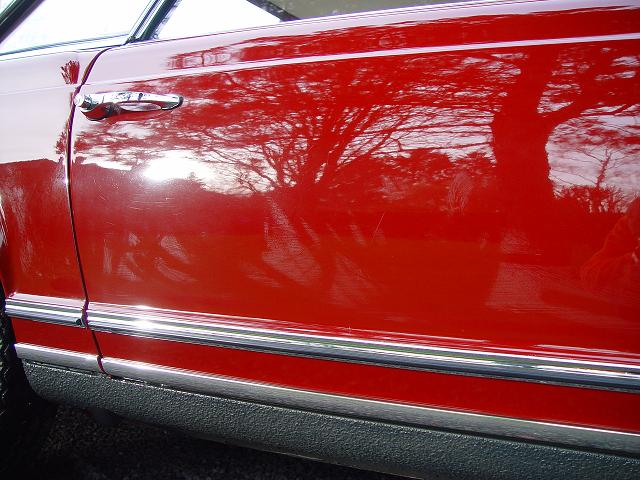

Also, I've been following a thread regarding the original color of rocker panels on Pagodas.  My 1965 230sl, which I believe to be untouched, has the panels painted in a mid-grey (see picture).
Anyone care to comment?

Mine are vinyl, not quite as good as new, but still extremely pliable without cracking as I had to lift them up recently to get rid a 'bump' or two under them.  Said bumps aren't big by any stretch, but have bugged me no end over the years so I pryed them up (after slicing thru the glueline to prevent undue stress on them) to find and remove the 'bump' culprits.... turn out they were due to the heads of a couple of the flathead screws used to hold the rocker cover down to the rocker... there are several of these hold-down screws, and the 'bump' ones were very slightly canted (slight mis-alignment of tapped holes in rocker with holes in rocker cover). I wouldn't have thought such a miniscule (thinner than your little fingernail tip) slight 'rise' of one edge of the flat-head would have created those bumps.
Anyway, in prying up the vinyl sill strips there was no cracking and though some temporary stretch, the retook their shape within a few minutes.  I solved the 'bump' problem by countersinking the rocker cover holes with the conical tip of my 3/4" drill bit... drilling at the approx.angle of inclination of the flat-head screw orientation in the bump locations.
On your medium grey rocker covers on your '65 230SL.... though all the photos from Engelen's book (see my post on the rocker cover thread) after the Geneva premier appear to be black, there are a couple that may be medium grey as late as a '67 250SL, but those photo's are B&W so I can't be sure.  There's a full page color spread of an early 230SL (still has the large round (cylindrical) coolant water expansion chamber mounted at the right rear corner of the engine compartment) that definintely shows black rocker covers. It's possible perhaps that there was an option of medium grey or black for some period time --- perhaps until the 280SL appeared.

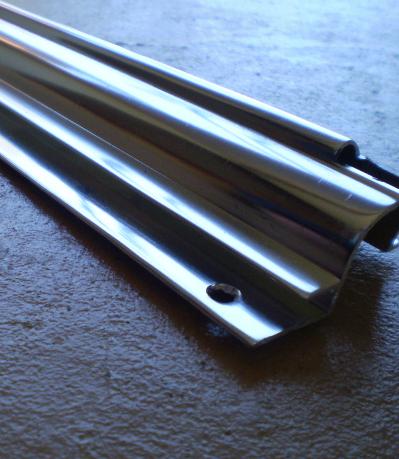

I have seen the ribbed vinyl/rubber sill tops, not sure if NOS or repro though
Anyone come across the shiny metal door strip that crimps the inner side of that rubber down. Mine is dinged up pretty badly. I don't think it's chrome though. Is this the part that was mentioned in another thread about K&K trying to get new ones made up?

« Reply #5 on: April 02, 2008, 03:53:43 »
I checked with K&K a month or two ago and they were still waiting on the repo inner trim piece, the one that gets kicked when you step in and out of the car.  I gave up on their repo, and am having mine redone by the same company that rechromed my bumpers.  They will rework the metal, take out the dents, scratches and repolish.
I'll take some pics and post once I get them back.

« Reply #6 on: April 02, 2008, 05:54:14 »
Bob, Tosh and others,
I managed, at the time of restoration, to replace these trim pieces at a reasonable price.  I believe they are made of clear-anodized aluminum.
The good news is that being aluminum, they are easy (well, in  a relative sense to a skilled craftsman!) to work.  In the process however, particularly in re-polishing, the anodizing will be compromised.  That only means you might need to, on occasion, take some metal polish to it to keep it looking tip-top.
It's astounding at how much abuse this one piece of trim receives even in a carefully owned car!
Tosh,
Saw some at Essen for €145.00 each.

« Reply #8 on: April 02, 2008, 09:05:31 »
About the metal door strip, I had mine replaced about a year ago.  The  shop seemed to have no trouble getting them at that time.  I think they were about $200 each and I believe they came from MB but I'm not sure.  About the rocker panel color I believe that is painted with 3M Autobodyshutz which is still available.  It is black but has a tinge of grey in it.

« Reply #9 on: April 07, 2008, 18:06:53 »
The two sill pieces and rubber insert are still available from MBZ.  I just spent a small fortune on both sides.  Buy new v. repro or refinished whenever possible.  My $.02.
