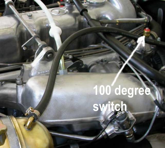

Hello Bob,
In your list, what do you refer to as "100 degree & 17 degree switch" ? Where is this located, and what purpose does it serve?
WAQAS in Austin, Texas
Re: M-B Head coolant recirculating kit
« Reply #7 on: June 19, 2007, 19:08:30 »
Hi Waqas,
The 100 degree switch is the switch that is screwed into the top of the thermostat.  Has a wire connected to it...
Download Attachment: 100ds.jpg
38.55 KB
The 17 degree switch is screwed into the engine block, down by the IP Pump. Also has a wire connected to it...
If unclear, please let me know...
« Last Edit: June 19, 2007, 19:36:58 by bpossel »

Thanks for the reply! I see you have a 280sl... these switches are apparently present on neither my 230sl nor the 250se/c...
I'm having slight overheating problems, and I just noticed a bead of coolant around the upper solder joint of the radiator... so looks like it's time to pressure test it and replace/rebuild it if necessary. It's strange, but I haven't lost much coolant, if any.  Thanks for your list (most items have been taken care of recently), but the timing might be a good thing to check, and with the help of that epic "adjusting timing" thread currently running, I should have all the info I need!  :D
