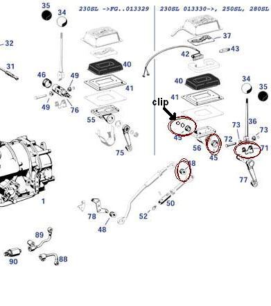

Last year I changed the bushings shown in the picture. The gear shifting feeling improved considerably and I got a much better feeling of the gear. I ordered the bushings with a small circle clip stoper that holds them together check if you still have yours.
