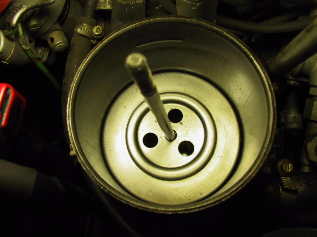

Something about the PS reservoir filter I don't understand:  why does the large washer that pushes down directly on the filter (the 250-280 Owner's Manual calls it a 'thrust washer') have three good sized holes in it (see picture)?  Doesn't this put the PS filter into permanent by-pass, no filtration being done?
Also, A Dalton said "The reason we check the filter first is b/c with a blocked filter , the suction side of the pump will pull into a vac.....".  Is there a filter thrust washer that doesn't have the permanent by-pass holes in it?  That would be the only way I can see that the pump would pull into a vacuum, and also properly filter the PS fluid.  Do I have the wrong PS filter 'thrust washer'?  Thanks.

WillS,
I just had a look at the pas filter (looks like a collar/bangle) - and I confused  :oops:
If the 3 holes at the bottom of the resevoir are for bypass, how does the fluid get to the steering box?
