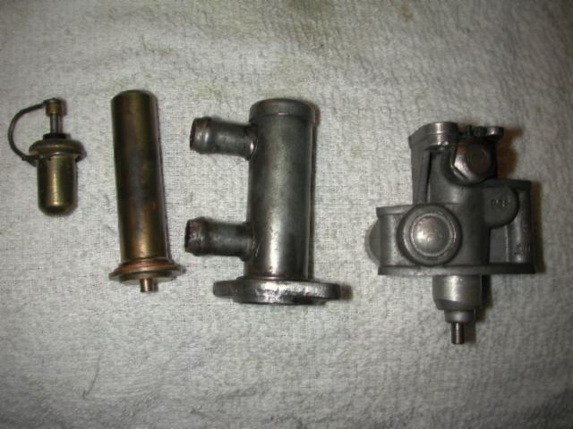

Hi, Bob,
Can't remember what the 280 valve looks like.
Here's one on the 230:
Right one in the pix. There's a plunger in the valve body operated by the thermostat. The pin at the bottom pushes on a plate in the pump.
(thermostat on left is from a 280, while the second one is from the 230)
Can you check if yours has this hex nut on the back?
Download Attachment: 230tstat.JPG
46.96 KB

« Reply #4 on: February 16, 2005, 17:05:23 »
Hi Bob,
The part Naj is speaking about does not interface with the oil in the engine.  Where do you have oil leaking?
The slide valve in the warmup device is spring loaded and open when the engine is cold.  As the engine warms, engine temp water is circulated through the warm up device on the injection pump.  A temperature sensitive plunger extends as the water warms pushing the slide valve down and choking off the air supply which comes from the injection pump air filter.  If you take the assembly off the car you should be able to manually slide the valve up and down in its shaft.  Let me know if you have any questions.
