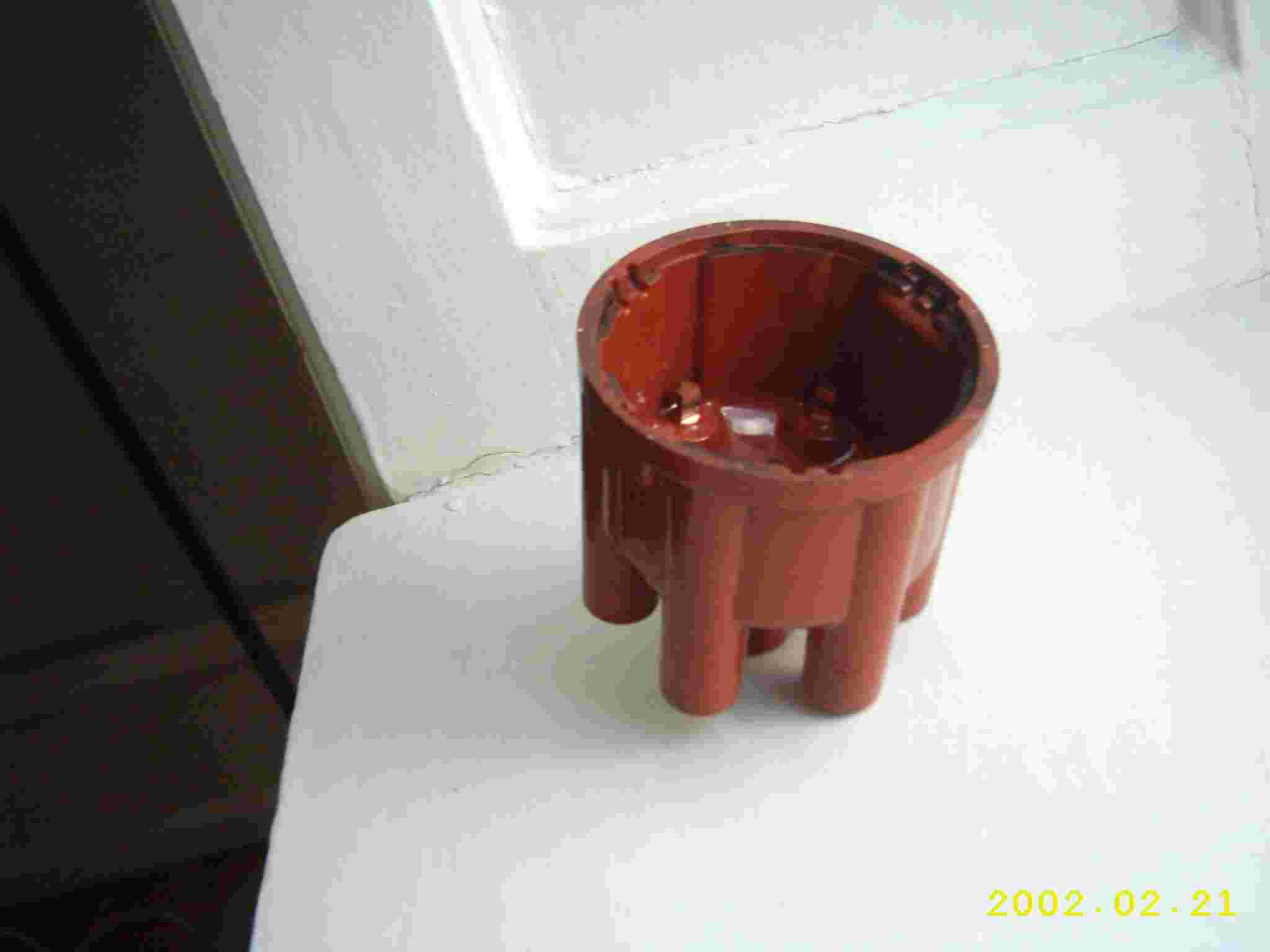

Here's the facts. Car is smoking black on acceleration. Cam, crank, injection and ignition are all in alignment. Compression is fine. When I put my timing light on any of the leads it flashes irregularly, some more serious than others. Checked the timing light on another card and it works fine. Dweel angle is fine too. I am offcourse going to do a full check on the ignition system working my way from the sparks towards the battery. However I pulled the distributor cap off and it was full of carbon tracks (see picture) Could this explain my irregular ignition or would you suspect something else? Also is there a difference between testing spark plugs outside and their function inside the cylinder?

I suggest you replace the distributor cap, they are inexpensive.
If there is too much oil inside your distributor, clean it with a dry cloth.
Add one or 2 drops of engine oil on the felt wick under the rotor.
Similarly apply a couple of drops to the external oil inlet of the distributor.
