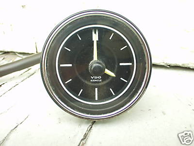

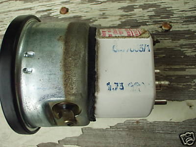

On the 1973 350SL the midddle hole of the 3 center dash vent outlets had a clock fitted there. This clock had similar bezel with the same diameter and movement as the earlier 113 clocks but didn't have the 113's studs on the back for a mounting bracket. The 107 clock had a rubber collar around the bezel that held it into the vent opening by friction.
Somewhere around 1974 when the existing stock of self-winding clock movements was used up both 107 and 113 replacement clocks were then made with a quartz movement, with studs on the back for 113s and without for 107s
107 clock with Kienzle self-winding movement.

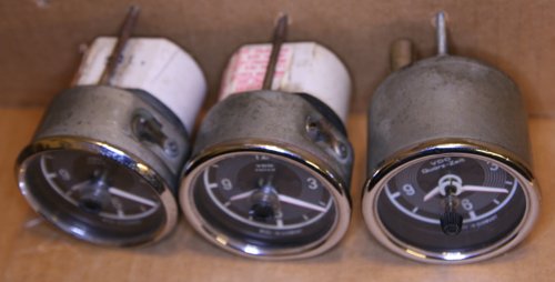

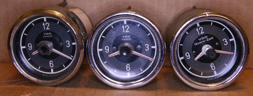

More dash clock photos:
Here is a sampling of the dash clocks that you are likely find in a pagoda.
Left:     Sharp Bezel, original from my 66 230SL, Part #113 542 00 11, date code 11/65.
Center:   Smooth Bezel, Part #113 542 01 11, Date code, 4/69.
Right:    Quartz Replacement Clock, Part #100 542 01 11, date code 12/79.
There may be other variations with subtle differences, but these are the ones I found in my goody box
Al

Amazing how some people in this forum just have the right answer to ANYTHING!
Great pictures, no need for further information!
Congratulations al ! :)

Just to add to the data: my clock only has VDO on the face, and above the shaft, not below like pictured above.  The car is a Sep. 64 230SL.  I am still digging the archives trying to fing the least painful way to replace the lightbulb for it.  Removing the glovebox?  Accessing from underneath?
