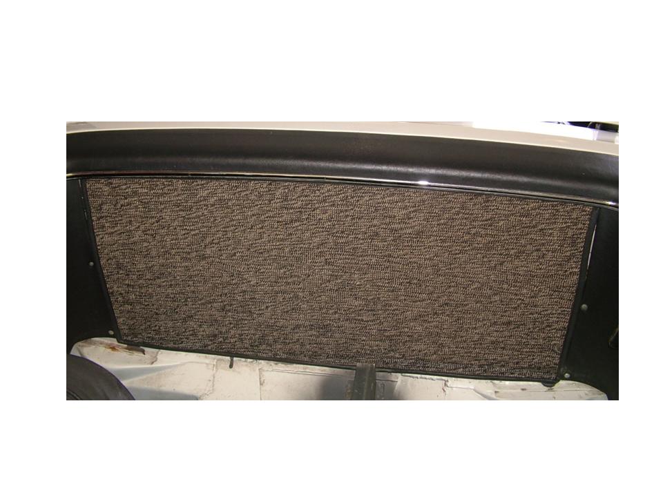

Here's a pic of my rear panel carpet. 1964 caviar. The MB Tex is black.
Steve
Download Attachment: rearcarpet-caviar.jpg
80.4 KB
Steve
