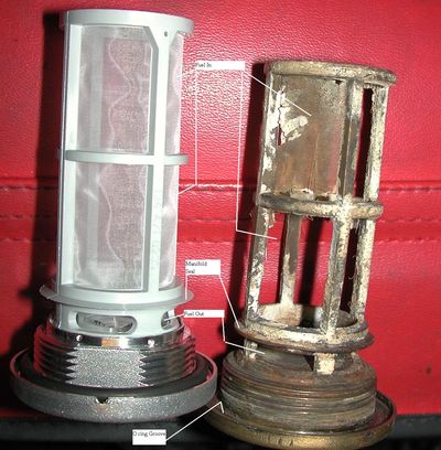

The drain plug/fuel screen in the fuel tank is the first line of defense to protect the injection system from contamination. This drain plug/fuel screen can be removed using a 22mm allen bolt (7/8") will work. One can make a tool using a 22mm bolt welded on a pipe (see picture). The unit has a rubber o-ring seal which should be renewed. New drain plug/fuel screens are available new if yours is damaged. My old dealer (280-SL)parts book show the number for the filter/plug to be #111 470 0686. The seal is listed as #022 997 0648 (corrected #s 0807). Earlier W113 cars may be a little different. I believe the earliest versions of this drain plug/fuel screen were brass plug with a copper screen while the later units are aluminum plug with plastic screen.
Picture below shows an aluminum plug with plastic screen and the earlier brass plug with copper screen. The copper screen is virtually dissolved away when the tank was cleaned with some sort of acid. Note the very fine mesh screen.
The next photo shows the tank bottom without the flower pot to show how the fuel manifold interacts with the fuel pick up line. Fuel going to the engine must first flow through the screen and into the round "fuel manifold" where it leaves the fuel tank via the metal line. After traveling through the electric fuel pump, fuel lines, main fuel filter, injection pump, left over fuel is returned to the tank via the smaller metal fuel return line and dumped into the "flower pot".
Notice where the fuel return line and the larger (lower) fuel supply line enter the tank. Notice that the metal fuel supply originates at a round collector (manifold) in the center bottom of the tank where it picks up fuel after it is drawn through the drain plug/fuel screen.

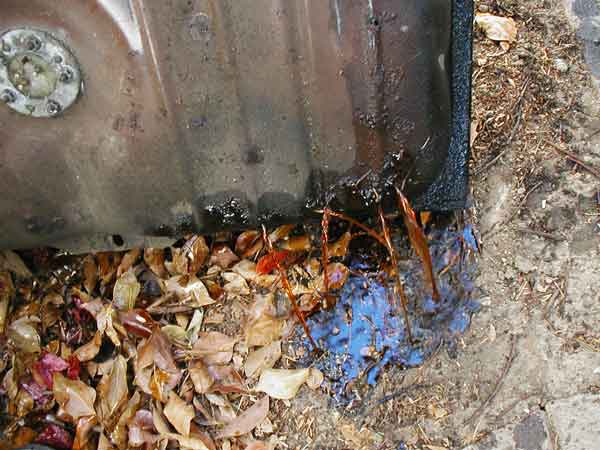

- Have heavy plastic gloves and a face protection. the chemicals used are nasty, if you have a respirator use it.
- When it came time to apply the sealer, with the help of another person I coated the sides of the tank, then did the bottom of the tank.
- To keep the sealer out of the fuel inlet in the flower pot, I removed the cover for the sender unit so I could see the bottom of the tank, then with the tank standing up, we slowly lowered the tank bottom side down and I watched the sealer as it flowed toward to flower pot, once it was approaching the inlet, we raised the tank just a little and allowed the sealer to just touch the bottom of the flower pot. We did this two times, then angled the tank around to get the sealer on the other side of the flower pot to cover the rest of the bottom of the tank.
- Re-install the home made sending unit cover, turn the tank over and seal the top of the tank.
- Per the instructions after waiting 8 - 10 minutes, drain off the excess sealant.

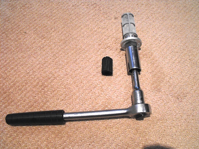

The drain plug can be removed using a spark plug socket with a hex head on the drive end. This socket should have a rubber insert used to hold a spark plug which you need to remove.
Push the hex end of the socket into the recess of the drain plug. Fit a long extension through the socket into the square drive from the bottom and remove like a regular drain plug.
CAUTION!!!!!!!! NEVER use a trouble light near gasoline. A loose bulb could start a fire with you covered in gas.
It happens far more often than you might think. Don't be stupid.......
