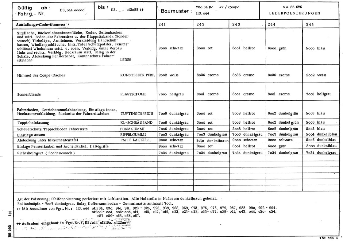

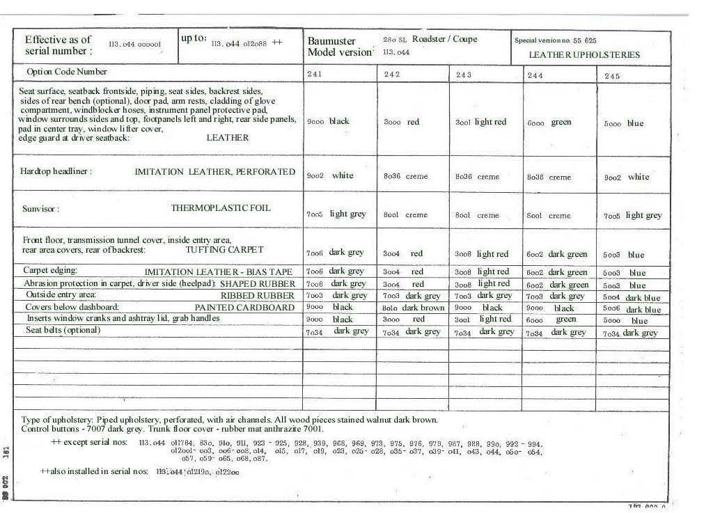

The choice of an upholstery had, of course, consequences on the colors used for other parts in the interior of the vehicle. For some - and not all - of these parts, production used tables which identified the correct combinations. Since there were frequent changes (three models, and about annual changes within the models), the correct combinations for an individual vehicle can be different from others in close serial number range. (Minor example: Early 230SLs had black ashtray lid covers, later ones had them color coordinated to the upholstery.)
An example for early 280SLs for code 241 - 245 is shown here in German; English below (67):
When trying to identify the original combination for the correct restoration of a vehicle it is therefore imperative to get the proper build-sheet for the serial number range of your car. This sheet can be obtained from the Classic Center.
On the other hand, this sheet also helps to identify which parts in a car ordered with leather upholstery are actually made of leather. Some parts are made of imitation leather (MB-Tex); also - not identified here in the table - parts made of leather can be regular leather (e.g. seats) or thin leather ("Spaltleder", e.g. crank inserts). And, but you knew that, it also shows that your beloved car is at least partially made out of painted cardboard.
