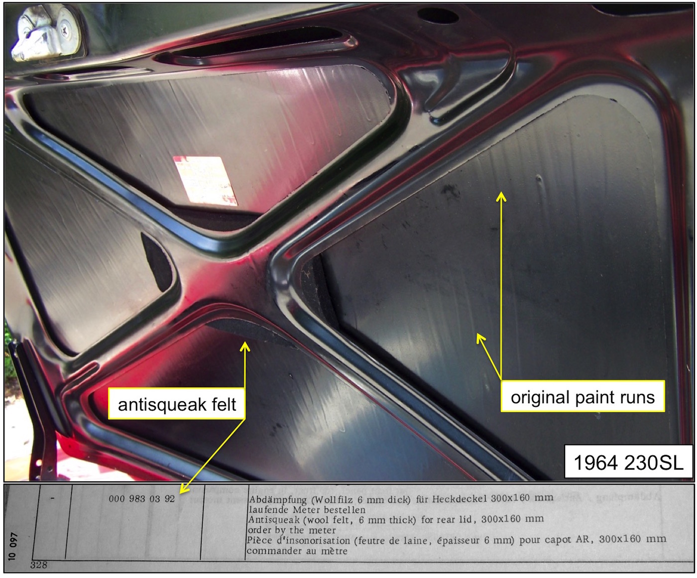

Regarding the pad under the trunk lid cross-member. I just measured mine on my 1967 230 SL. It's 3/8 inch thick felt. It's a little difficult to get an accurate measurement across the top of the bow of the X member, but I got 11.5 X 6 inches.
It is interesting that the earlier cars had felt. My 1971 was some type of dense foam rubber that really looked like new after 30 years and I hope to find an original replacement from a parts car.
